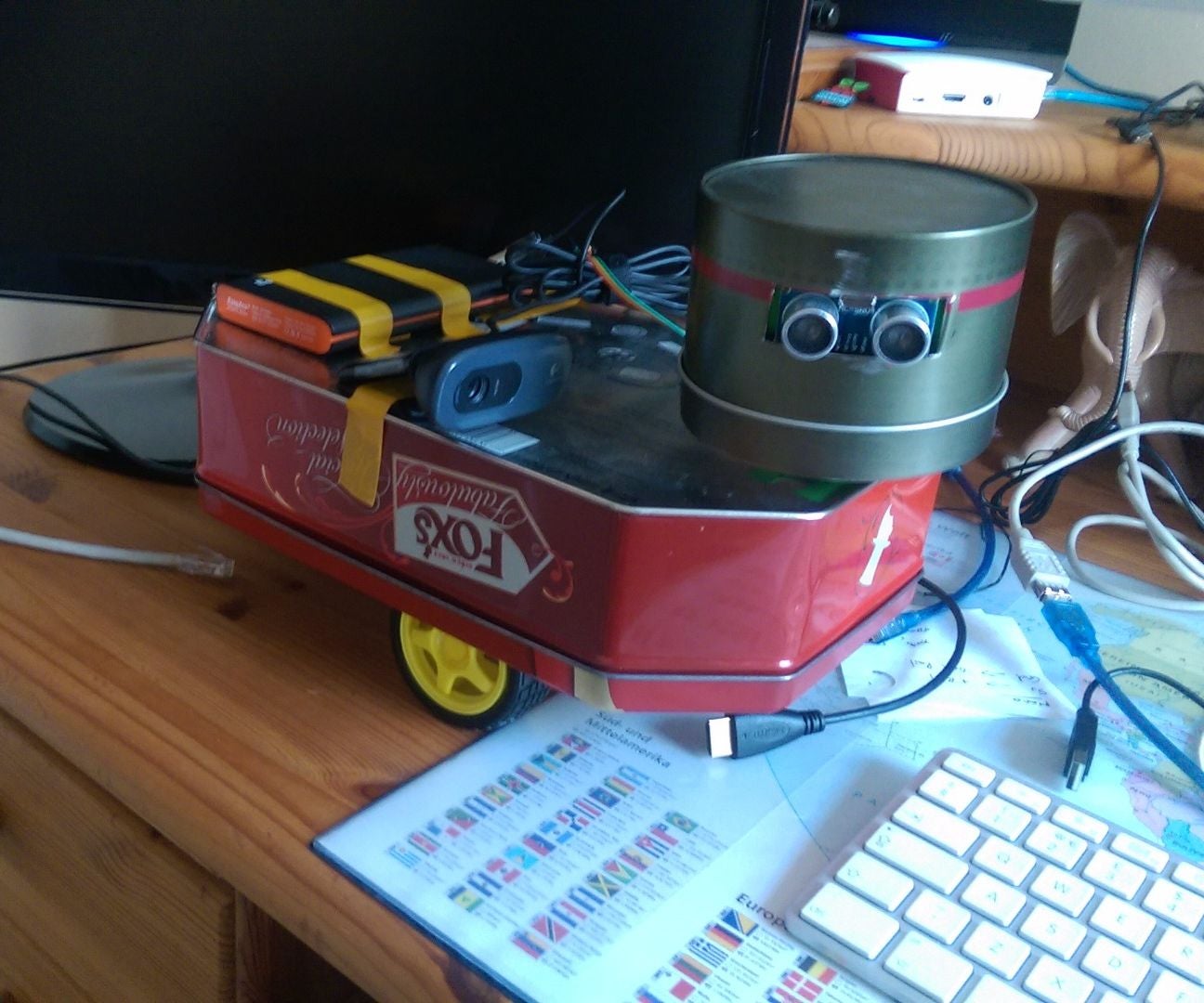

Hi;
I have a posted a couple of threads around this forum and the help I have received has helped me to successfully build my Robot.
Here is the not yet finished Instructable:
It is a Raspberry Pi / Arduino Hybrid, the Arduino (Nano AT-Mega328P) drives the Motors, Ultrasonic Sensor and a Servo that the Sensor is mounted on. The Nano is connected to a Raspberry Pi as a Slave receiving commands via an i2c Serial Interface. The Raspberry Pi acts as the i2c Master and serves a Web Page using WebIOPi on which is a control panel to control the Robot wirelessly over WiFi. The Robot also has a USB Web Camera mounted on it which streams video using MJPG-Streamer at about 20fps to the control panel web page.
I have recently changed the Sketch code so that the Robot also has a timer function that puts it into Autonomous mode if does not receive any commands after a given time period and it detects movement (not confirmed that this is working yet).

When the Nano receives an integer 1 - 4 which is sent by the Pi when the user click Forward, Left, Right or Backwards on the web interface control panel served by the Pi, it runs the corresponding module. The problem is that even if you do an short click of the movement button it runs the module for about a second which when turning left or right causes the robot to spin almost 180 degrees. I need this to be more controllable?
