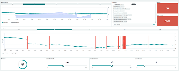

I have a watering system in production but its watering when it shouldnt, this only started yesterday to be fair and could be because the sensor got slightly wet when I watered in some seeds although it didnt seem to affect it at the time just a long time afterwards
so I attempted to tune the sketch over the air and now its asking me to update the firmware, which I really dont want to do as its in production and would mean taking it all apart and luging it in
anyone else had this issue and overcome it?

when I try to upload it I get "Connectivity firmware update
Update the connectivity firmware to upload the sketch and enable the new version of the IoT Cloud library."
this is my dashboard that shows the watering events over the threshold
any thoughts would be appreciated
You have to apply the new firmware.
Why didn't you address the issue with the sensor first of all?
I am not sure what you mean, I was addressing the watering/sensor issue but I couldn't send the sketch OTA as it required the firmware update
My mistake, thought you was trying to fix an issue with the wet sensor by new firmware. Yet, you should make sure the part of the sensor with electronics is dry before anything else, or you risk corrosion.
yes the sensor did get misted, I dried it off, the erroneous watering happened after that but not immediately, it was a day or so after. I was looking to smooth out out the reading and and add a delay so that it wouldnt water under the threshold, I wanted to send that correction OTA but it said I had to update the firmware. In the end I had to break down the unit and plug it in to do the firmware update, all seems to be working again for now at least. this is an evolution of a system that I have used in the past and I hope to scale it up to my veg plot which will be .4 of an acre, I will gravity feed the water via pipes using solenoid valves, the capacitive sensors will also be upgraded although the industrial ones I saw do not seem to be available or at least were not last time I looked
You got links for those industrial? I got a capacitive sensor myself and it's a interesting field. Also how to calibrate the readings to something useful.
I cant find a link for those now, they were always sold out anyway, they appeared to be a longer version of these here I have opted for the IP65 DFRobot Gravity: Analog Waterproof Capacitive sensors for now
here is the code I am currently running, seems to be working ok for the moment

you can see where I had these erroneous watering events, hopefully now sorted
