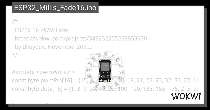

Independently fade 32 (connected) LEDs with an ESP32. Totally non-blocking.

Not sure what is non-blocking, it just loops through 16 LEDs and sets pwm value from 16 element array. Also what is the difference between duty[j & 15] and duty[j]?
Do you can see any sketch ?
Likewise ... however I just meant there's no delay()s used. Ironically, a small blocking delay at the end of loop() improves the simulator's response.
Can't use duty[j] as it will index beyond the array size, however using duty[j & 15] allows indexing through the array in both forward and reverse direction without overflow. Timing of direction change is determined by line 18. Timing of fade is determined by line 19.
How come? j is 0…15 array is 16 elements long, what am I missing?
j is a byte counter variable, counts up or down 0 to 31 to 0 etc.
Gotcha, didn’t notice the loop was using i not j

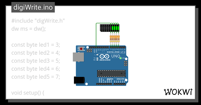

Flashing 1 to 16 leds couldn't be any easier ...
digWrite()
Description
  • Non-blocking millisecond timer control for up to 16 pins.
  • Automatic pin management and configuration.
  • Writes a timed HIGH and timed LOW value to a digital pin.
Syntax
ms.digWrite(pin, on, off)
Parameters
  • pin The pin number *(uint8_t)
  • on timer value in milliseconds (uint16_t)
  • off timer value width in milliseconds (uint16_t)
Returns
  • nothing
Add more LEDs if you want (here's 5)...
#include "digWrite.h"
dw ms = dw();
const byte led1 = 3;
const byte led2 = 4;
const byte led3 = 5;
const byte led4 = 6;
const byte led5 = 7;
ms.digWrite(led1, 2000, 2000);
ms.digWrite(led2, 1000, 1000);
ms.digWrite(led3, 500, 500);
ms.digWrite(led4, 800, 200);
ms.digWrite(led5, 50, 150);
