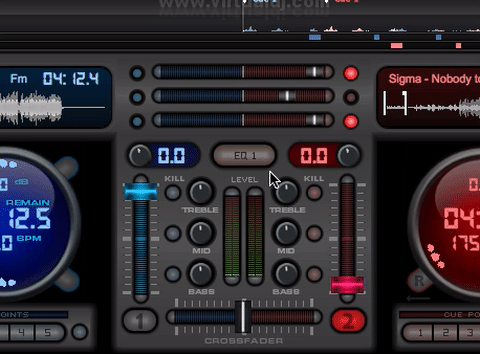

Hi, I'm currently making a MIDI controller glove, using flex sensors.
I've gotten it working, however the small value changes make the midi output "stutter" (please view the video). That makes the controlling inaccurate.
I would really appreciate advice on this, as its so close to completion. I feel like the answer is quite simple, but I'm new to Arduino.
Below is the code I used

A first step would be to add array indices to all finger, minFinger, and maxFinger in your loop.
