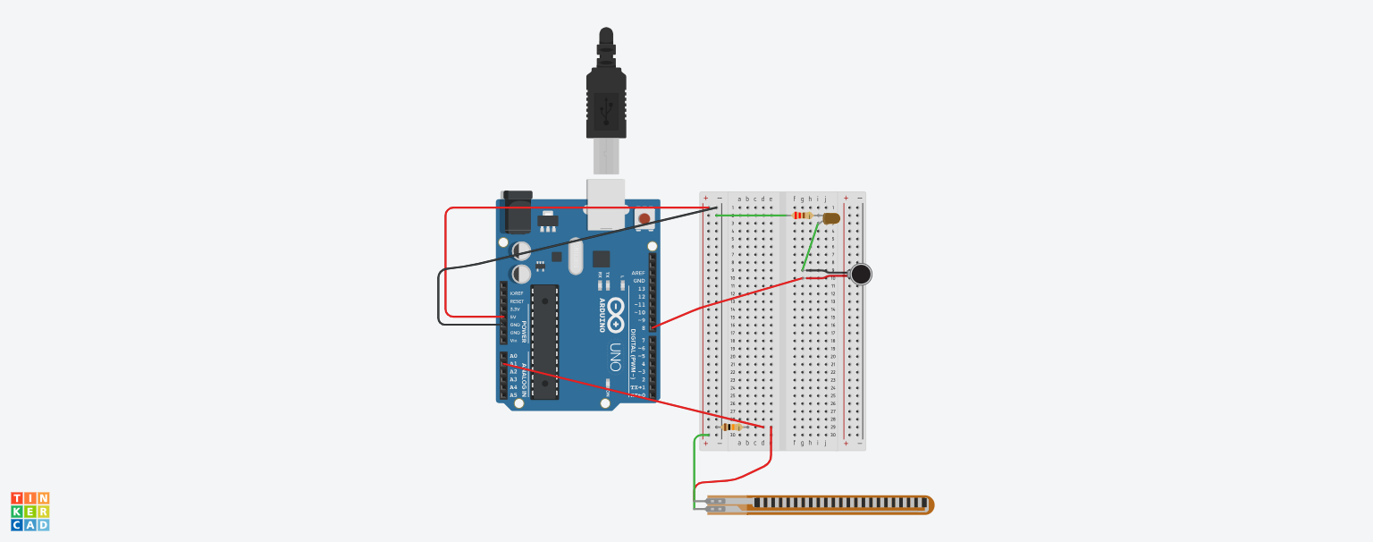

Hi everyone,
So I'm using an Arduino UNO to build a circuit that will have a flex sensor detect changes in stomach circumference and at a certain threshold, will set off a vibration motor and LED simultaneously. The circuit looks like this (using 10k resistor for flex sensor and 1k for LED):

Everything worked fine until the soldering for one of the ends on the flex sensor broke off, and I had to re-solder it. The soldering job was done well enough, but when I set-up the circuit again, my live readings from the flex sensor just came out to "0", with no amount of flexing changing this value. I thought the resistor might not be enough, so I switched out the 10k for a 47k, but the readings still remained inaccurate. Any ideas? Thanks so much for anyone who stumbles across this :frowning:

Also, running a vibration motor from a DIO pin will cause problems from feedback into the DIO pin.
Read here. Arduino Vibration Motor Code, Circuit, Control (Tutorial)
Show a picture, well-lit, of your solder job - both sides if applicable.
You broke it. Buy a new one. Those flexible PCBs are not very robust and almost impossible to fix.
You get a reading of zero because your flex sensor now looks like a short circuit. Nothing can be done by changing the external resistor because your sensor is a short circuit.
Guess it was a job NOT done well enough. Follow @Grumpy_Mike suggestion and get a new one.
