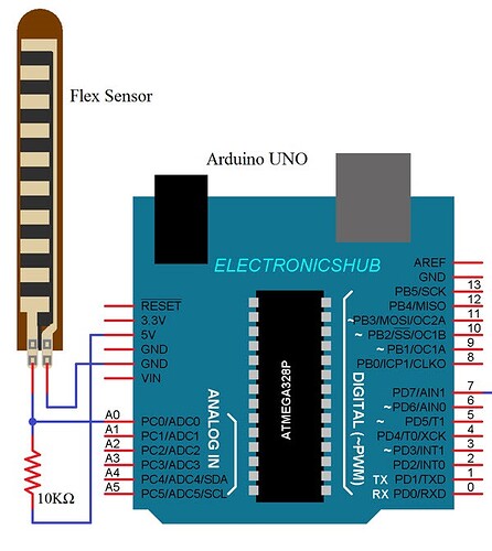

Flex sensors problem with arduino uno without breadboard
this is a schematic

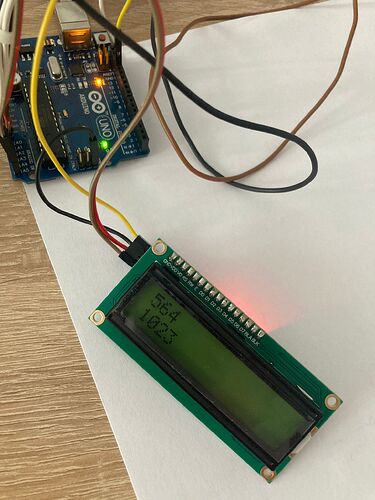

well, what is result on display with sketch from post#19 ?
oscillates between 564 and 565
did you attempting to bend ?
when I move only one of the sensors, it changes from 565, when I move the other, nothing happens on the display
how big is change?
broken connection to GND side
from 565 to 600-750
good. it is working.

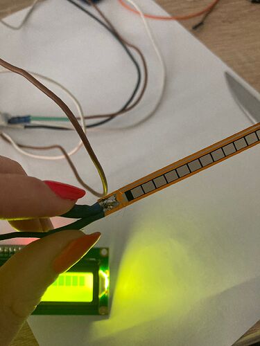

what can i do to make it work?
the second one? check wiring
I removed the silicone around the cables and now it oscillates between 1014-1023
1009-1024

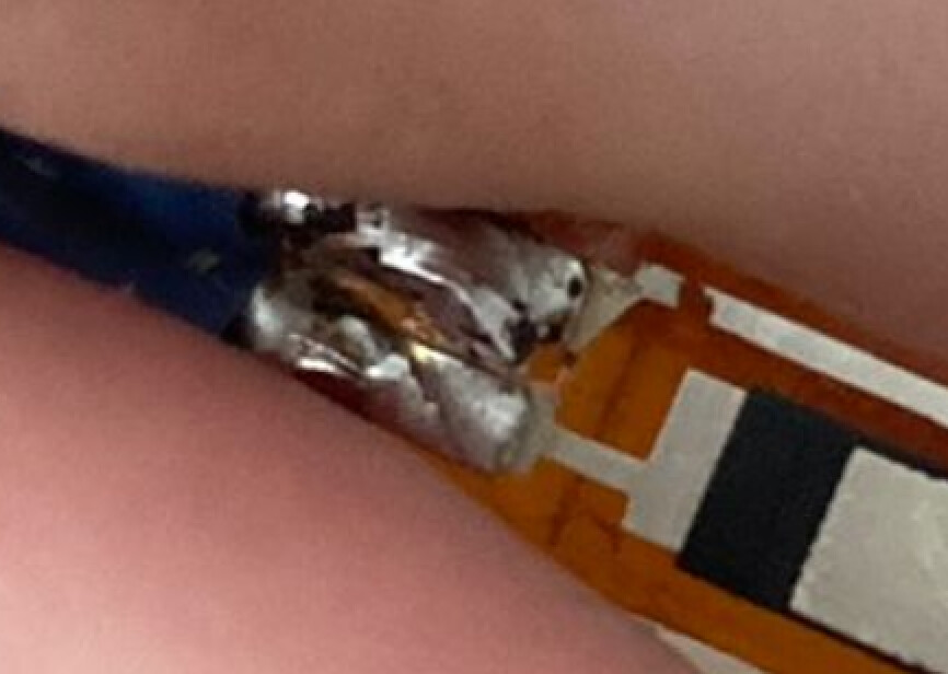

broken here?
зображення
I think so
Gently scrape white tips of the broken wire to expose the copper under the white. Bridge the gap with copper wire or a blob of solder. Alternatively, the opposite end might have a solder point for the wire.

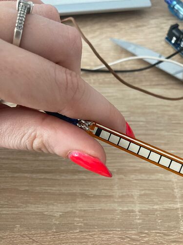

I changed the sensor, now it works but I can't calibrate it
why you want to calibrate? you note unbend value and bend value. then you switch controlled thing depend on measured value
If i note the bend and unbend value, on display is not the right value of sensor. How can I fix this ?
