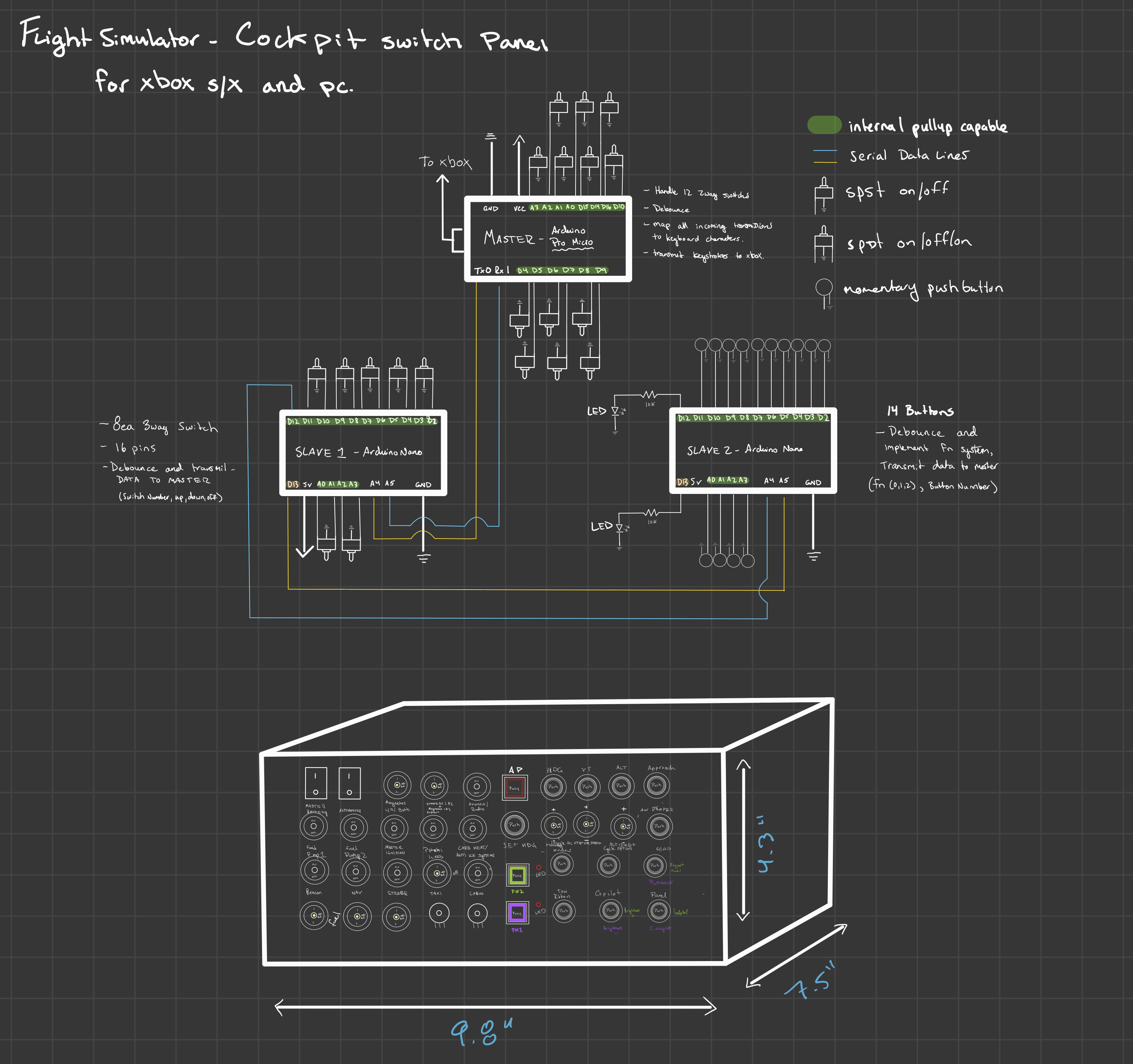

Looking for some guidance on a project i stumbled across on instructables that i am trying to build with very basic knowledge of arduino, more complex understanding of electronics.
Its a flight sim controller found here: https://www.instructables.com/Flight-Simulator-Switch-Panel-for-XboxPC/#discuss code is on git hub here: GitHub - j-bagdonas/flight-sim-switch-panel: Source code for a homemade flight simulator switch panel peripheral.
The project basically involves using 2 nanos and a micro to provide Inputs. the inputs should translate to ASCII keyboard format, i have the correct libraries loaded.
Im 99.9% sure i have wired it all up correctly, i am managing to get data from the second slave all the way through to the master and printing keys. The issue is no matter what input button i press i am getting ]z]p as the ouput. i beleive the problem to be with how the master converts the input coming from the slaves into an ASCII number but it is beyong my level of understanding despite my best efforts. Has anyone on here built this or can provide some guidance on a solution?
I have managed to configure the micro and nano combo to provide inputs for alphabet a-z, the issue seems to be coming from the function buttons which are used to provide a secondary key assignment for the same push button , like pressing ctrl shift .
I have run a seril monitor on all boards and the pins are checkin out to the correct ones but at the master all it see's is :
Sending key command for data: 84

Show a wiring diagram and your wiring.
Show this, too... None of the source code has Serial.print() so it looks like you left some "debug" statements in for keycode and position... which means you probably mangled other code.

Hi thaankas for the quick response.
There is a vague wiring diagram on the instructables page page showing the power and serial paths/pins. Im fairly confident electronics wise. Here is the diagram: [https://content.instructables.com/FL4/5ZTX/LB0SVUV3/FL45ZTXLB0SVUV3.png]

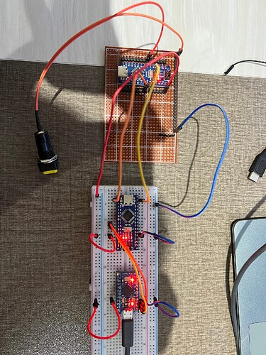

Wiring shown below, apologies for the glare i have spot lights right above my work area, great for work, less so for pictures.
Im using a breadboard plus one soldered nano on a perf board, i have continuity tested between all pins to ensure to cross over with my soldering.
What we need is a photo of your hand drawn wiring diagram. Also ALL the code in code tags and any verbose error logs and serial output also in code tags.
You want me to search for a vague diagram? Make a working diagram and post it.
No, it is not. Why do you ask for help then disregard it?
As stated below, all i have connected is the power between the boards, the serial connections between the boards and one button i am moving round between the common ground bar on the perf board and the input pins to keep the board clear.

Until you draw a wiring diagram and post a picture of it we will take the wiring as good.

So a different angle of attack, as I remain of the opinion that your wiring must be the problem.
