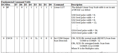

I've tried that, with different rows: 0 / 16 / 32 / 48 / -16... (the display has 32 rows). It did not change. Digging through the data sheet I only found this:
For others with similar displays like the SSD1306 it seems to work just fine, no further work required. I'm still lost what might be the problem here.
anselmpaul:
According to that datasheet, it should have just worked.
1.1.15 Set COM Output Scan Direction (C0h/C8h) This command sets the scan direction of the COM output, allowing layout flexibility in the OLED module design. Additionally, the display will show once this command is issued. For example, if this command is sent during normal display then the graphic display will be vertically flipped immediately.
