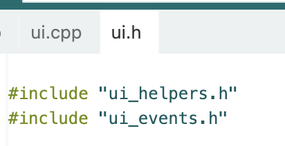

There are at least 2 more files as can be seen here.
ui_helpers.h (4.1 KB)
ui_events.h (313 Bytes)
