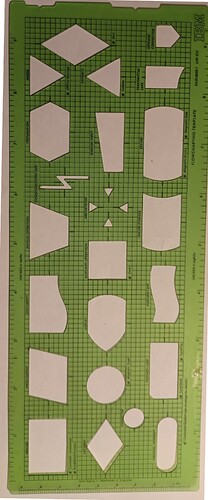

And for the retro look go to to your favorite antique tech store and get a flow chart template. Here is the one I used for years.
