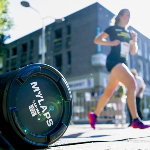

A commercial product. Up to 800,000 dogs at one time.
