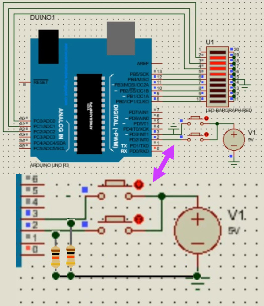

for learning purpose, what changes can make this code

Auto-format would help.
And more appropriate constant datatypes.
Then get rid of the delays.
i mean , millis() function , if else statement, switch case , something like that
Yes, all of those things, probably. And at least an array
Do you know how ‘arrays’ are used? Do you understand how to use the BWD ‘blink without delay’ technique? Do you know how to use ‘switch/case’?

So rather than fix it, you left it?
AWOL: So rather than fix it, you left it?
because i am not sure ,i am only in bigging stage
You could've asked for advice.
if (digitalRead(sensor1) == HIGH) {
What happens if you let go of the switch, do you want things to restart ‘or’ do you want things to continue?
Are you sure you want two switches controlling the same outputs.
Edit:
Are you okay with code that blocks sketch progression, as it is now, or do you eventually want to see multiple things occur at the same time?
  for (int i = 0; i < 10; i++) {
    for ( int j = 0; j < 10; j++) {
      pinMode(outputArray1[i], OUTPUT);
      pinMode(outputArray2[i], OUTPUT);
      pinMode(button1, INPUT);
      pinMode(button2, INPUT);
Why two nested for loops ?
This might give some ideas how your current sketch can be changed.
However your delay() is blocking sketch code progression.

https://youtu.be/-FdmAVHk-Ao
need to work like this
