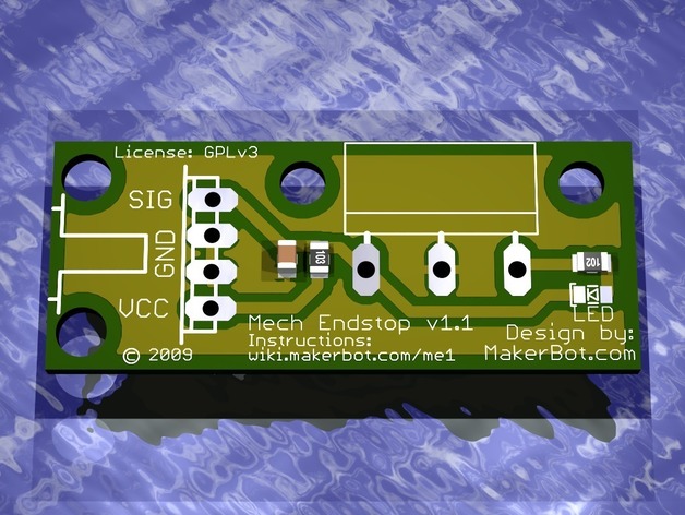

I just connected this endstop switch to an arduino nano that I had laying around. Gnd was connected to gnd, +5v was connected to the +5v pin and the signal was connected to D4. When I plugged the mini in I saw an error on my computer screen mentioning that the USB port was drawing too much current. I unplugged it immediately, after I unplugged it I noticed a plume of smoke wafting away from the mini.
What did I do wrong?

Thanks for all of the comments. This morning I took a quick look at the switch.
R1 looks to be a current limiting resistor for the LED. I tried measuring the R2 but wasn't able to get a solid reading I'm guessing because of the cap that's next to it. I did find a picture of the same style of switch where R2 had 103 listed on top. That would indicate that R2 is a 10k resistor correct?
When I measure resistance between the +5v and signal without the switch pushed no reading (obviously). When I measure resistance between +5v and signal and the switch is pushed the meter reads 10k ohms, as you would expect. Great! But when I measure resistance between +5v and ground there is almost a short (1.25 ohms). How would this work in my 3d printer then without frying the arduino mega?

There's very little reason to have bought that switch module. Those microswitches themselves are a few cents, the Arduino has internal pullup resistors, all you got was a waste of space and a little led.

How is what I did different than the end stop switches shown in this schematic:

I do have another nano, I'll put connectors on the other stuff and try again. But my question remains. Based on the schematic referenced above how do the end stop switches that I purchased work with an Arduino mega but not a nano?

The question doesn't remain. You're blaming the switch when it's most likely whatever you did to the Nano.
