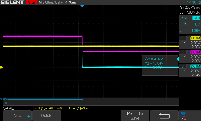

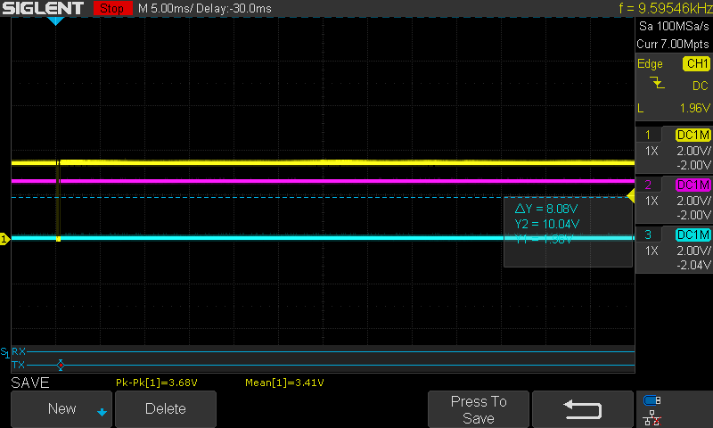

So I hooked up my scope to the TX, RX, and RESET lines in order to capture some traces for people here to look at. It seems as if the arduino isn't responding properly. For reference, the colors are as follows: FT231 TX (yellow), FT231 RX (pink), RESET (blue).
RESET being pulled low when programming starts. Also noticing that the RX line is being pulled down to ~2.25V which is interesting. Not sure why that would be but that's definitely suspicious. Could be why the programming is failing. |500x300
The first (and only) byte I was able to capture from the FT231 - 0xE0 - this is a 500ms sweep. Something tells me more should be going on here and it's not. |500x300
So I suspect that the RX line (TX from the ATmega) being pulled down to ~2.25V could be the issue here. Still, I'm not sure why that's happening in the first place.

I wrongly remembered where the capacitor was placed and didn't double check. Still, I wouldn't think that's the issue but who knows.
I think it is the issue.
The DTR lead through the cap should just be a pulse so the bootloader can run.
Yeah - I just came to that realization through looking at my scope traces and now I get it.
Makes total sense now that I think about it. My brain just told me "decoupling cap" when I saw the RESET line with a cap on it and I left it at that.
