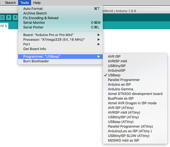

You select "Upload using Programmer" rather than "Upload" in the Sketch menu...
No bootloader needed. The list of possible programmers is in the tools menu.

Say for instance i have an uno to program mu atmega2560 over ICSP. What settings do i need to use?
Arduino as isp programmer? This is not clear to me?
Select Arduino as ISP

and how will the programmer know if i'm using a 328p or an 2560?
See
https://www.arduino.cc/en/hacking/programmer
