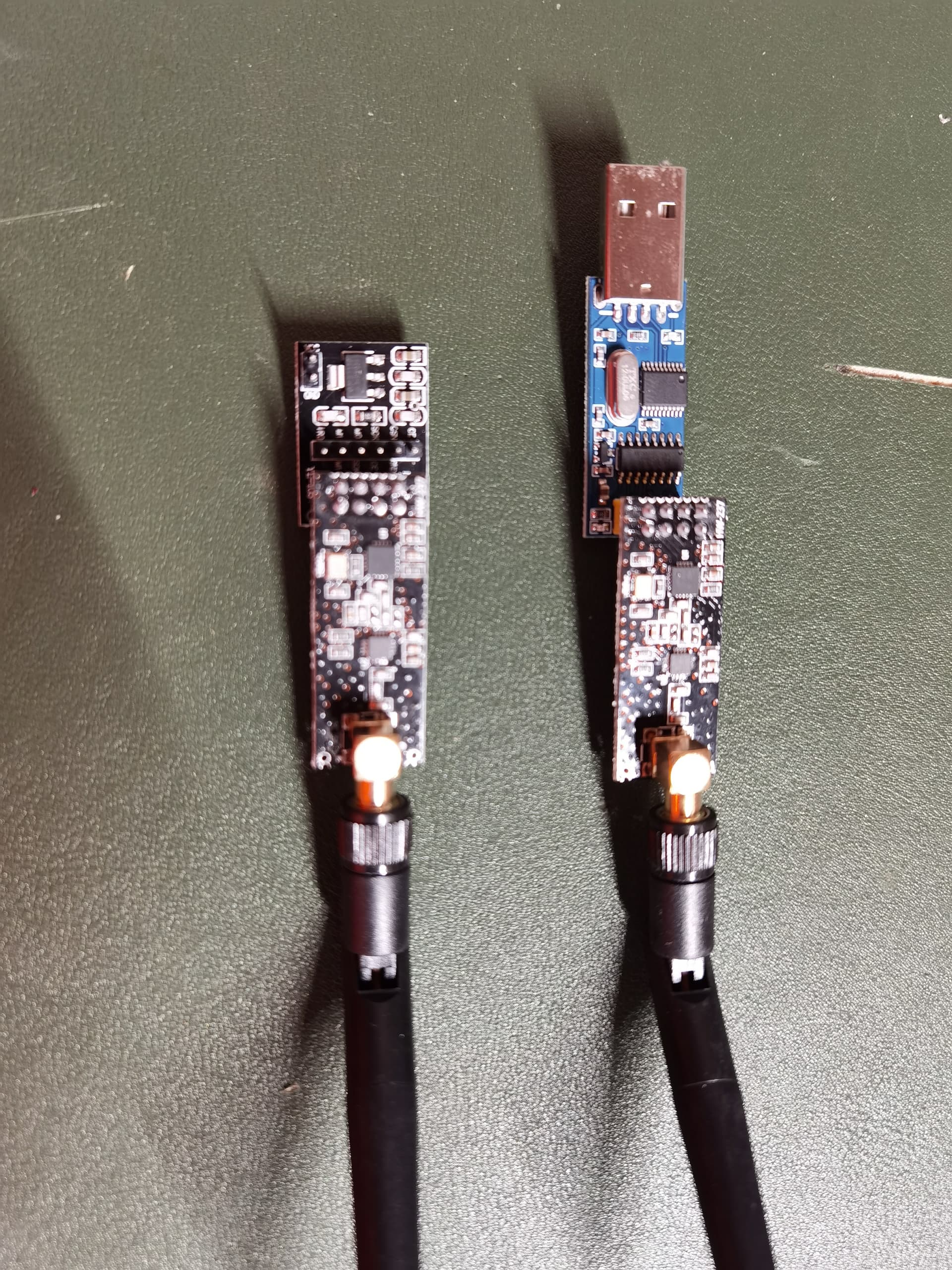

I bought two data transfer modules NRF24L1, and there is also a USB adapter for one of them. Is there any example to use the combination of these modules as computer-arduino, arduino-computer?

Your devices are TRANSCEIVERS!!! They either transmit or they receive. Not both at the same time!
Yes, define one side as the master (my suggestion: the PC) and only this side is allowed to initiate a communication. That means your car isn't allowed to send data to the PC, the PC has to ask for every sensor measurement and the car responds with a defined message, so the PC knows when the message is finished and it may ask for the next item.
