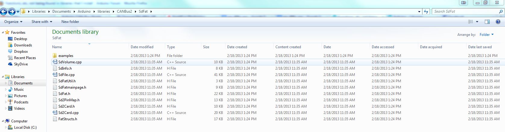

Can you please give the full pathname of where you put the library? Does it look like this?
Here's a screenie. Full path would be C:\Users<user name>\My Documents\Arduino\libraries\CANbus2\SdFat

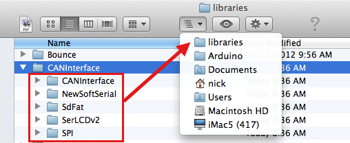

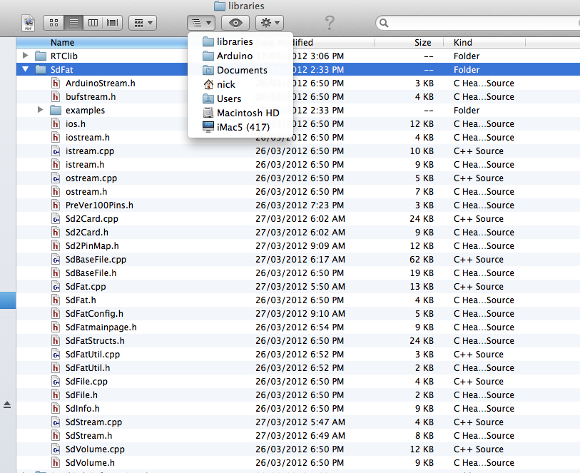

There are a few odd things about that. For one thing, it seems to supply various things (like SPI) that already exist as libraries. Second, the SdFat library seems to me to be one level too low. For a third thing, the folder name is different to your screenshot. Also SoftwareSerial is now used in place of NewSoftSerial.
Try moving everything up one level, like this:
Then restart the IDE.

No, they're not. You have SdFat inside CANBus2. It should be inside libraries.
what do you propose to fix the issues you noticed?
Put those folders inside libraries, not inside CANBus2. Also you may not need SPI at all. As for NewSoftSerial, that suggests the whole thing is a bit old, however you could run with it and see what happens.

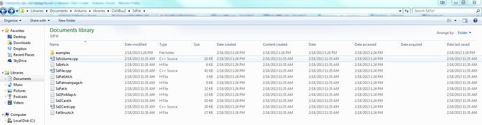

So noted. As for the header and .cpp files that are stored in the CANInterface folder... do those just stay where they are?
As you can see from my screenshot I ended up with 2 x CANInterface folders. Assuming you moved all the lower-level ones up a level (which would require renaming the upper CANInterface as "foo" and then deleting it afterwards) then inside libraries/CANInterface you would expect to see various .cpp and .h files, along with an "examples" folder.
