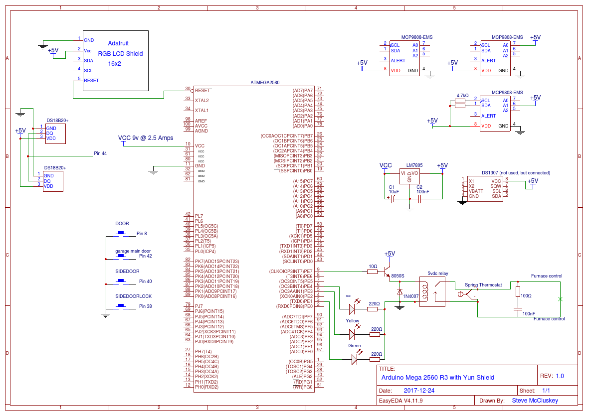

Is it possible that the 24v AC voltage from my furnace would cause a microcontroller to hang?
My furnace thermostat wire shows 24VAC and its shorted together by a 5VDC relay on my protoshield.
Could that cause RF interference even tho the two circuits are completely electrically isolated?

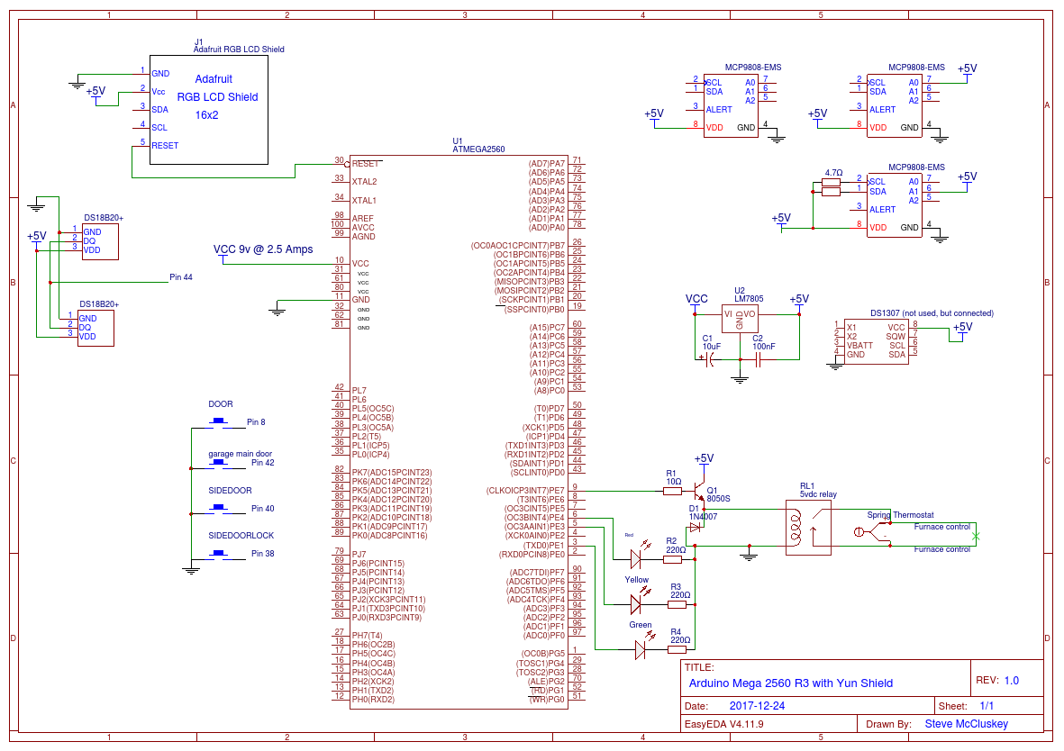

updated schematic:

Don't put a diode across the CONTACTS, it will conduct on HALF the AC cycles when contacts are open and may burn the furnace relay out.
The diode is across the coil, not the contacts.
Have you measured the AC current that flows though the thermostat wires when you connect them to turn the furnace ON?
As pointed out earlier by @justone
You are HIGH side switching the thermostat relay with and NPN transistor.
You should be LOW side switching with the NPN to make sure the Relay coil gets full current.
OPs, relay circuit.
The Thermostat wire should run straight from the relay terminals and away from the rest of the controller, the wires should not run next to any power wires or low voltage wires associated with the controller.
Tom.. :slight_smile:
You mean 5v -> relay coil/diode -> NPN -> gnd?
Why does it matter? The relay seems to switch on and fine. It's very small and only draws 35 or so milliamps. It's small enough to be run via a digital pin with no other circuitry.

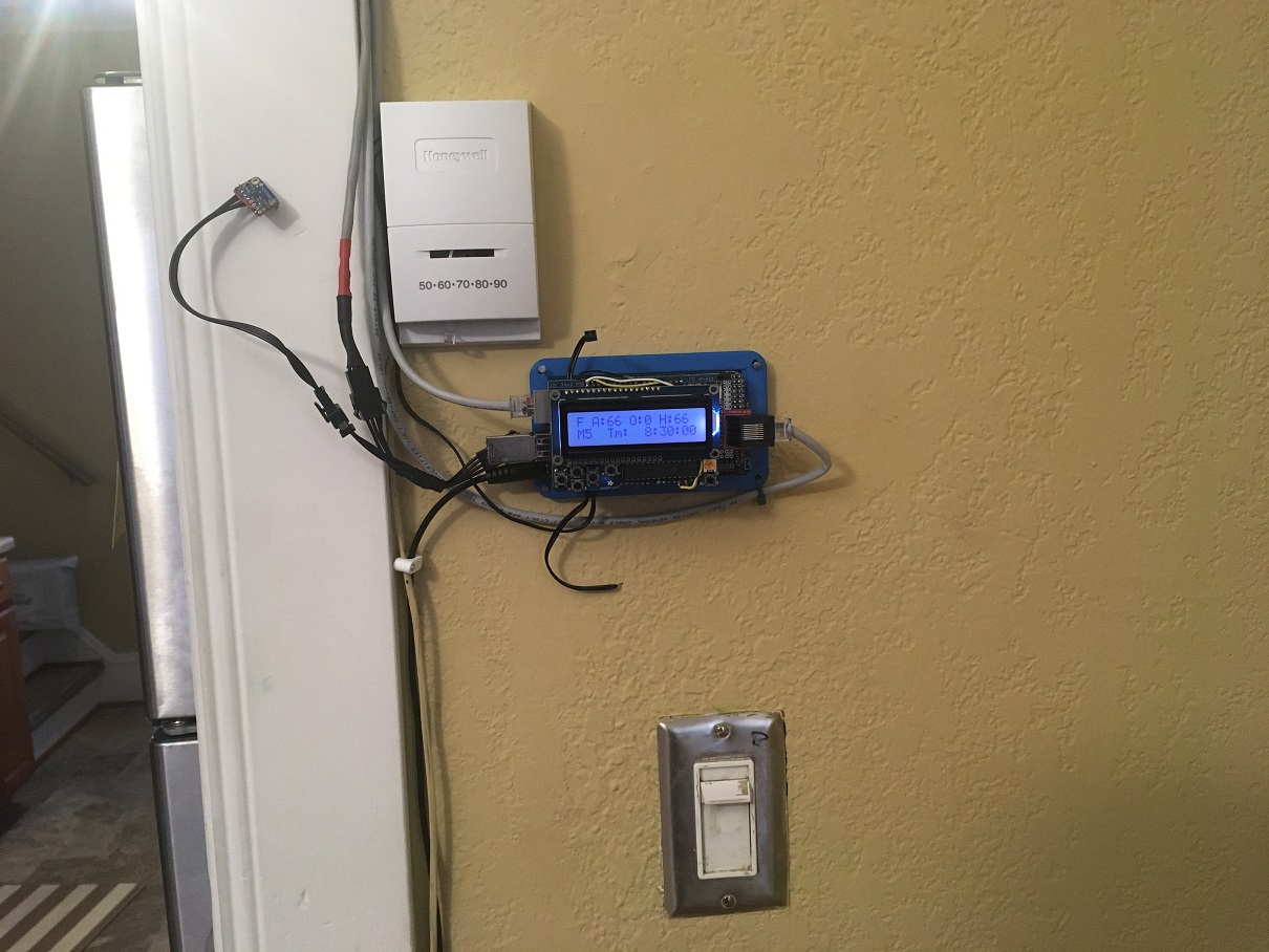

The thermostat wires do run near everything else. I will fix that asap. I'm going to use the relay to remotely power ANOTHER relay near the furnace itself so all voltage to and from my thermostat is DC. only the 24vac from the furnace will go thru the second relay which will have its own local power source. another level of isolation.
Another thought I had is that the thermostat is mounted on the wall near AC wires and a dimmer switch that doesnt dim any more. Its only on or off. That will be much harder to fix as moving the thermostat involves moving a LOT of cables.

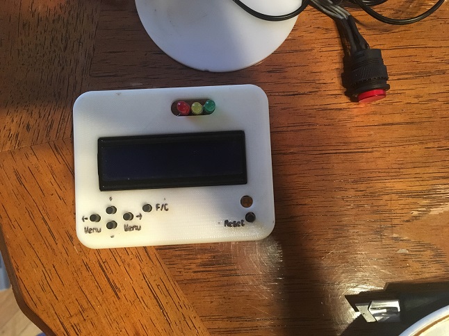

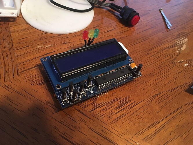

photos attached. Im currently using a second LCD shield with RGB for now. The other two photos are of the original LCD shield with LED's attached and the cover i printed.

Why does it matter?
Because when something is manufactured and specified, it is a synthesis of design and testing that is not totally accessible to the user (also incorporating many factors that are usually beyond the understanding of the user). The specification is like a contract between the manufacturer and the user. If you want to deviate from it, you are basically attempting to second guess the engineers without having the complete picture that they do.
You can drive a relay with an emitter follower (common collector) circuit as you have, but you will lose 0.7V at the relay, so that it is running on 4.3V. If you check with the specifications and find evidence that it is okay, then there is nothing extremely wrong with it other than that it isn't optimum. Since you can power the relay with a common emitter circuit as has been described in a previous post, it makes no sense to do it unless you have a compelling reason for it.
Frequently, a system is as strong as its weakest link so we try to make all the links in the chain as robust as possible, especially if there is no cost or component saving in deviating from it.

I have a very limited understanding of transistors. All I know is that in an NPN, a small voltage at the base allows current to flow from the emitter to the collector. I dont understand why it matters if the load is before or after the transistor as this seems like it would be in series. Anyway, it works for now.

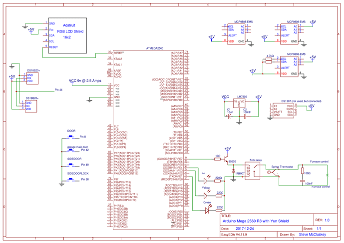

As per Paul__B's private message :

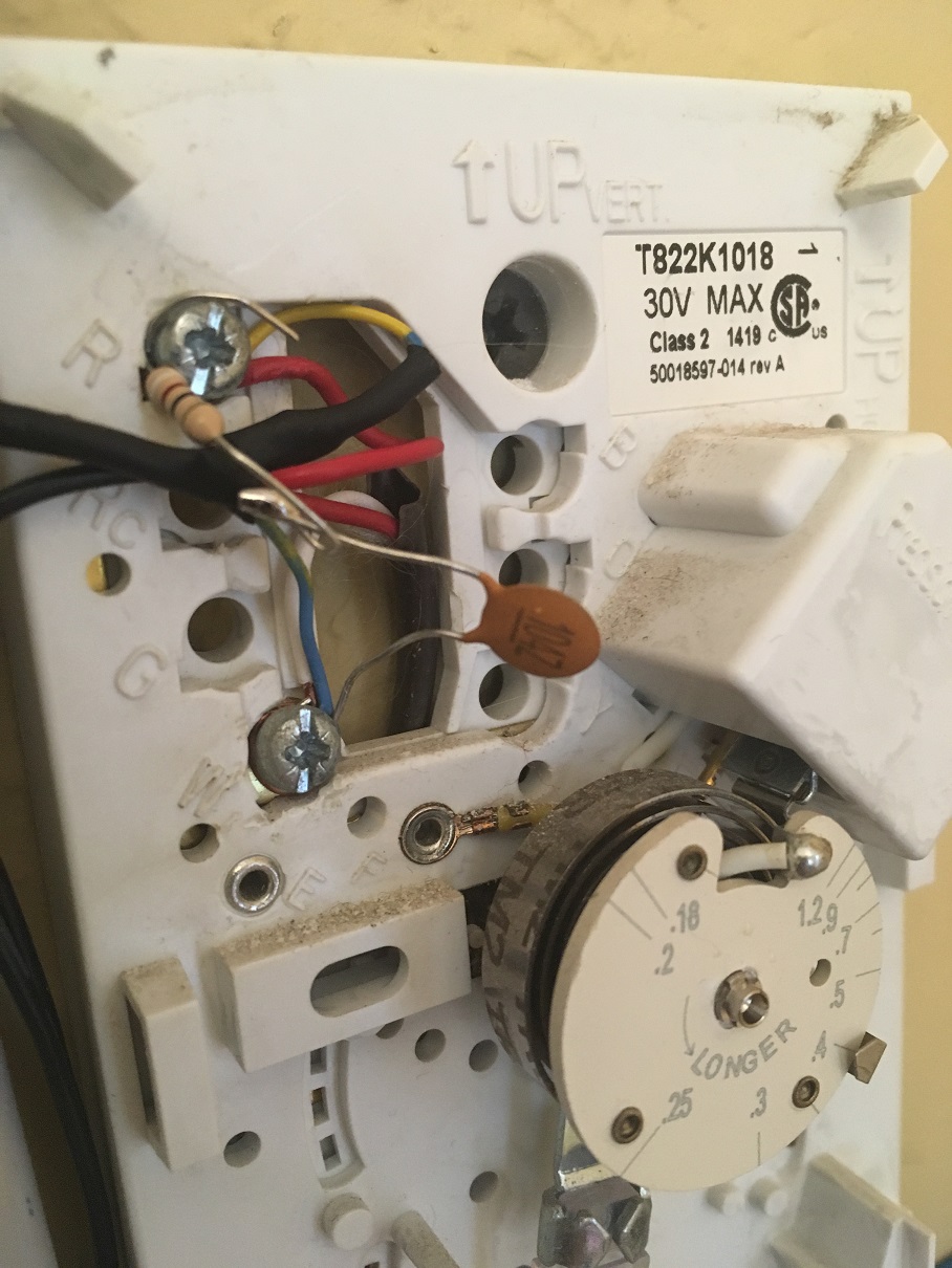

In that case, what you need is a "snubber" circuit across the contacts of your relay which connect to that control line. This would typically be a 0.47 µF capacitor in series with a 100 Ohm resistor.
I have added a .1uf ceramic capacitor (its the largest I had) in series with a 100ohm resistor ACROSS the control wires to the furnace as shown in the newest schematic. Honestly I was skeptical this would work at all because (in my VERY limited understanding of electronics) AC passes through capacitors and with a low resistance value I thought this would be the same as shorting the two wires.
I have installed them temporarily in the spring loaded thermostat and the relay is currently working fine to switch the heat on and off. I will keep you posted on if the arduino freezes. I will also try to move all AC away from it tomorrow (stores are closed, merry xmas!).
here is a photo of the spring thermostat with the R/C across its terminals:
again, these terminals and the arduino's relay are wired in parallel.

I thought I explained that. There is a 0.7V voltage drop across the EB junction (I'm simplifying things somewhat, this is just a rule of thumb). In the common emitter circuit, that voltage is not in the output current path. In a common collector circuit, it is, and so the 0.7V drop is in series with the load. Hence the output voltage will be VCC-0.7V = 4.3V
Regarding the "it works for now"... the whole point of engineering is to ensure that it not only works now, but later too.
I think you need to realise that a BJT is a current input an current output device.
When conducting current, a voltage of 0.7V is dropped across the Base - Emitter junction.
How did you arrive at 10R as your base resistor?
