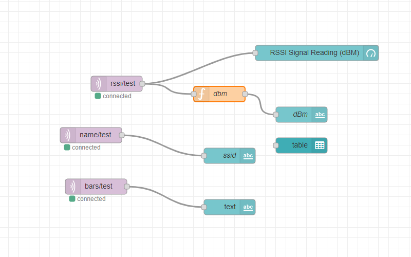

Hi, im working on a project that scans the wifi networks nearby with rssi values and I need to print it after scanning. Im using an esp8266 nodemcu. I'm also using node-red and printing it via mqtt using mosquitto. My problem is that the SSID, RSSI values are printing one by one. I need my loop to get all available networks before printing it. Im thinking of placing it into an array and printing that but my programming skills are kinda limited.
Here is the code im working on

The picture of the node-red flow is attached if it helps. Thanks in advance!
Why do you want to collect the information on the microcontroller? MQTT is a protocol for small packages with "single" values. Your current situation is what the protocol was intended for.
You should collect the packages in node-red. This runs on a machine with a larger processor and way more memory. Do the heavy lifting there. You could even use a database like influxdb on your node-red machine and store the data in there and do analysis using node-red influxdb nodes.
I have a similar experiment running for month now.
