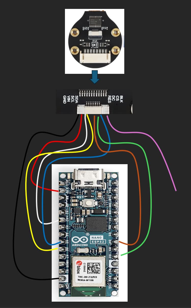

I am trying to get my display to run the test example (color\_Test)file that came with the TFT\_eSPI library and I get a blank screen. I am confident that I have the user selected setup configured correctly with pin assignments for my setup. The file loads fine to the Arduino Nano ESP32 S3 with no errors but nothing happens. I used an oscilloscope to probe the pins with the program running and all pins show 3.3V except for the SDA pin which shows a square wave and the SCL pin is showing nothing (0V). I believe there should be a signal on the SCL pin. I have tried several different pins for the SCL output with the same result. Any advice is appreciated to get this working.

**Try swapping SDA and SCL.**
If you're seeing clock signals on SDA, something is likely wired incorrectly SCL is the designated clock line in I2C communication. Swapping SDA and SCL won’t damage anything, and it's a quick way to rule out a wiring issue.
Also, **make sure you have appropriate pull-up resistors** (typically 4.7kΩ–10kΩ) on both SDA and SCL lines. Many I2C devices include them internally, but some do not, and missing pull-ups can cause unreliable communication.

Thank you. I am certain I have the lines connected properly unless they are mismarked on the GC9A01 device itself. I will try the pull up resistors on the SDA and the SCA lines. (need to go out of town for 5 days so likely won't get to try it until then)
I appreciate the feedback.

You should show your wiring diagram and code.

**Author:** ![patl](https://dub1.discourse-cdn.com/arduino/user_avatar/forum.arduino.cc/patl/32/1098795_2.png) [@patl](https://forum.arduino.cc/u/patl)\

![image](https://europe1.discourse-cdn.com/arduino/original/4X/e/8/3/e8311fca5b3ed51149ba1924ec80d9ca904198a7.jpeg)
```arduino
// See SetupX\_Template.h for all options available
#define USER\_SETUP\_ID 46
#define GC9A01\_DRIVER
#define TFT\_SPI\_PORT -1 //added by PatL to make sure overrides on pin settings are used
#define TFT\_MISO -1 //was 19
#define TFT\_MOSI 23// was 23 also czlled SDA
#define TFT\_SCLK 19 // was 18
#define TFT\_CS 22 //was 15 but Don't have it on my board - Chip select control pin
#define TFT\_DC 2 //Data Command control pin
#define TFT\_RST 4 //Reset pin (could connect to RST pin)
//#define TFT\_RST -1 // Set TFT\_RST to -1 if display RESET is connected to ESP32 board RST
#define LOAD\_GLCD // Font 1. Original Adafruit 8 pixel font needs ~1820 bytes in FLASH
#define LOAD\_FONT2 // Font 2. Small 16 pixel high font, needs ~3534 bytes in FLASH, 96 characters
#define LOAD\_FONT4 // Font 4. Medium 26 pixel high font, needs ~5848 bytes in FLASH, 96 characters
#define LOAD\_FONT6 // Font 6. Large 48 pixel font, needs ~2666 bytes in FLASH, only characters 1234567890:-.apm
#define LOAD\_FONT7 // Font 7. 7 segment 48 pixel font, needs ~2438 bytes in FLASH, only characters 1234567890:.
#define LOAD\_FONT8 // Font 8. Large 75 pixel font needs ~3256 bytes in FLASH, only characters 1234567890:-.
#define LOAD\_GFXFF // FreeFonts. Include access to the 48 Adafruit\_GFX free fonts FF1 to FF48 and custom fonts
#define SMOOTH\_FONT
#define SPI\_FREQUENCY 10000000 // was 40000000
#define SPI\_READ\_FREQUENCY 20000000
#define SPI\_TOUCH\_FREQUENCY 2500000
// #define SUPPORT\_TRANSACTIONS

Also, in the reviews of this display on Amazon, someone said ..... " I just had to change the spi data mode to spi\_mode0 in dev\_config.cpp and then everything started working.". I don't see how to do that.
I had watched the suggested video before attempting the setup. His esp32 board is a little different in configurations so I change the pin out to match my board. I only wanted to run the color test that is included as an example with the TFT\_eSPI library to verify the display hook up was correct but that's when I got stuck because the screen stays black. I have 3 of these displays and tried another w/o success. I also tried taking the BLK pin high by connecting it to the 3.3V and that didn't help. When I get a chance next week, I plan to try the pull up resistor suggestion on SDA and SCL lines

Did you follow (both understand and execute) the DroneBotWorkshop instructions for editing the library file?
> You will need to make a couple of modifications in order to get the library working, as it was meant for several types of displays and processors.
Would you add a "display pin/signal/mcu pin" table in your wiring image? "Purple" is an antenna? Don't make it so you can read it. Make it so everyone can read it.

I am on the road for the next several days and will need to follow up on this next Wed when I am able to . Thank you for the followup though
To answer your questions though, I did follow the instructions for editing the setup files, although I used the user\_setup\_select process and used the user setup file I posted (046). The purple is simply not hooked up . It is the BKL pin on the display and he had it hooked up to 3.3V. Other people don't hook it up at all. IAs I mentioned above, I did try it with it hooked up to 3.3V and it didn't change anything.
I will add the pin assignment table explicitly to make it more obvious. (it is shown in the picture of the wiring and cross referenced to the setup file pin assignments)
Does anyone have any suggestions on my question of the Mode0 recommendation from the Amazon review?(in the above post)

All wires should connect at both ends, or they act as an antenna. Sensitive micro-electronics might pick up on that (not saying this is the cause, just stating a best practice).
Also not important, but when I see SDA and SCL I think "I2C" rather than "SPI" where I think MISO, MOSI and SCK (and SS). Is there a "SPI" (or the signals) enable or a "I2C" (or the signals) disable?
I do not have a solution. I can only ask questions that (hopefully) help you toward a solution. Sometimes, after you have stared at the same thing for so long that "everything" is right, but "nothing" works... it only takes a second set of eyes and a question that seems irrelevant... and poof, there it is...
Or, it broke in shipping. (but I doubt anything broke)

I am back in town and trying to get the display to work again.
Here are the pin outs in table form:
| GC9AA01 Display | BLK (Pu) | 3.3V |
| GC9AA01 Display | CS (Blu) | 22 (A5) |
| GC9AA01 Display | DC (Gr) | 2 (D2) |
| GC9AA01 Display | RES (Or) | 4 (D4) |
| GC9AA01 Display | SDA(MOSI or DIN) (Y) | 23 (A6) |
| GC9AA01 Display | SCL (SCLK or CLK) (W) | 19 (A2) |
| GC9AA01 Display | VIN | 3.3V |
| GC9AA01 Display | GND | GND |

Here is a bit of an update. I switched the pin outs to what I was told was a more standard set of pins to possibly eliminate another variable. I am now using:
| BLK (Pu) | 3.3V |
| CS (Blu) | 10 (D10) |
| DC (Gr) | 2 (D2) |
| RES (Or) | 4 (D4) |
| SDA(MOSI or DIN) (Y) | 11 (D11) |
| SCL (SCLK or CLK) (W) | 12 (D12) |
| VIN | 3.3V |
| GND | GND |
Since I am not getting an output signal at all ont he sclk pin but was getting one on the SDA/MOSI pin, I had ChatGPT generate be a simple sketch using the new pinout to simply see if the pins would output the sclk signal. It did generate an oscilloscope signal as expected. The color\_test program does not so I suspect there is something missing in the setup process using that example but am not experienced enough to figure out the difference between the code other than that the color\_test relies on the User\_Setup file that I have checked several times. Here is the code/sketch that will generate a sclk signal. It seems like until I get a signal on the SCLK pin, other actions are not going to help unless I misunderstand how the display works.

After many hours/days of beating my head against the wall, I read on github that apparently the more recent versions of the TFT-eSPI library fail with the ESP32. The choice is to revert to a pretty old version or add "#define USE\_HSPI\_PORT" to the user setup file before pin assignment. This now at least gives me signals as measured on the oscilloscope on both the SCL and MOSI pins.
I still am not getting any display but at least I can narrow my focus a little. I may return the displays I bought (Jessinie GC9A01) and try a different brand
