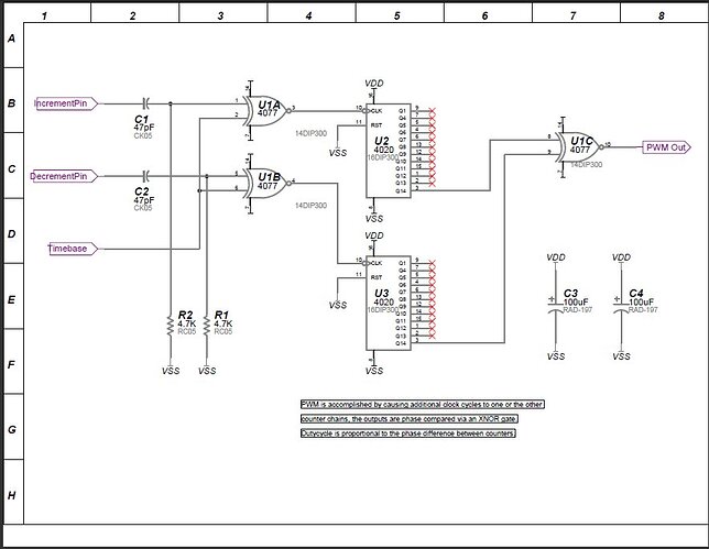

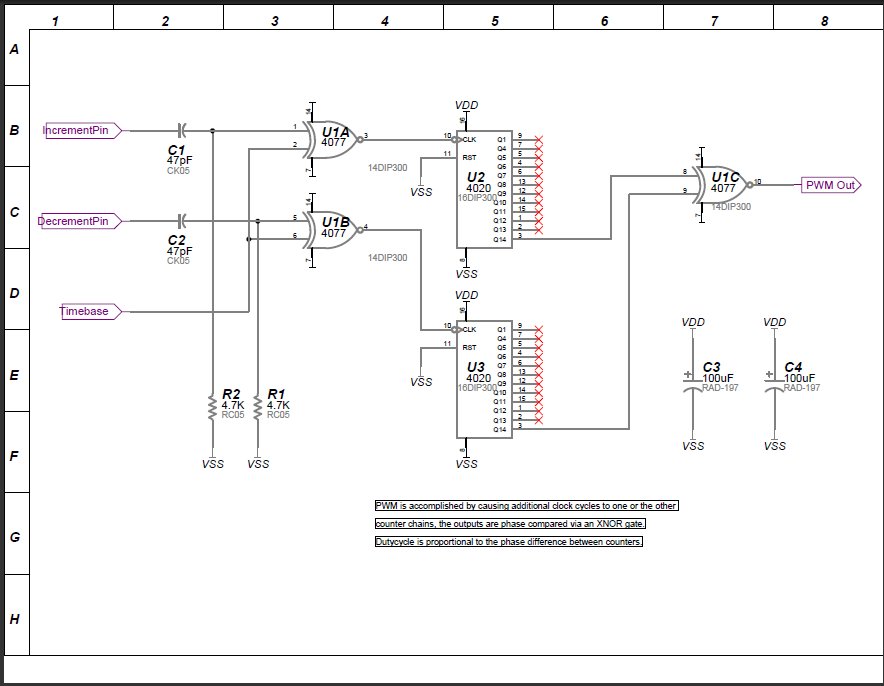

The project UIControl.ino is a test container intended to test the interfaces on class ExternPWM.cpp. ExternalPWM.cpp is the class library and ExternalPWM.h is its header file, and cmos.h is the enumeration. Below is the schematic of the circuit to be controlled. The increment and decrement pins induce additional clock cycles for a given counter chain thus altering the relative phasing at the output XNOR gate. The result is a continuous wave PWM that retains dutycycle and does not require process time when duty cycle is not being changed. The circuitry works as I have used the blink code to run a continuous advance on one counter resulting in a linear symmetrical PWM ramp.
scematic: ExternPWM.jpg
