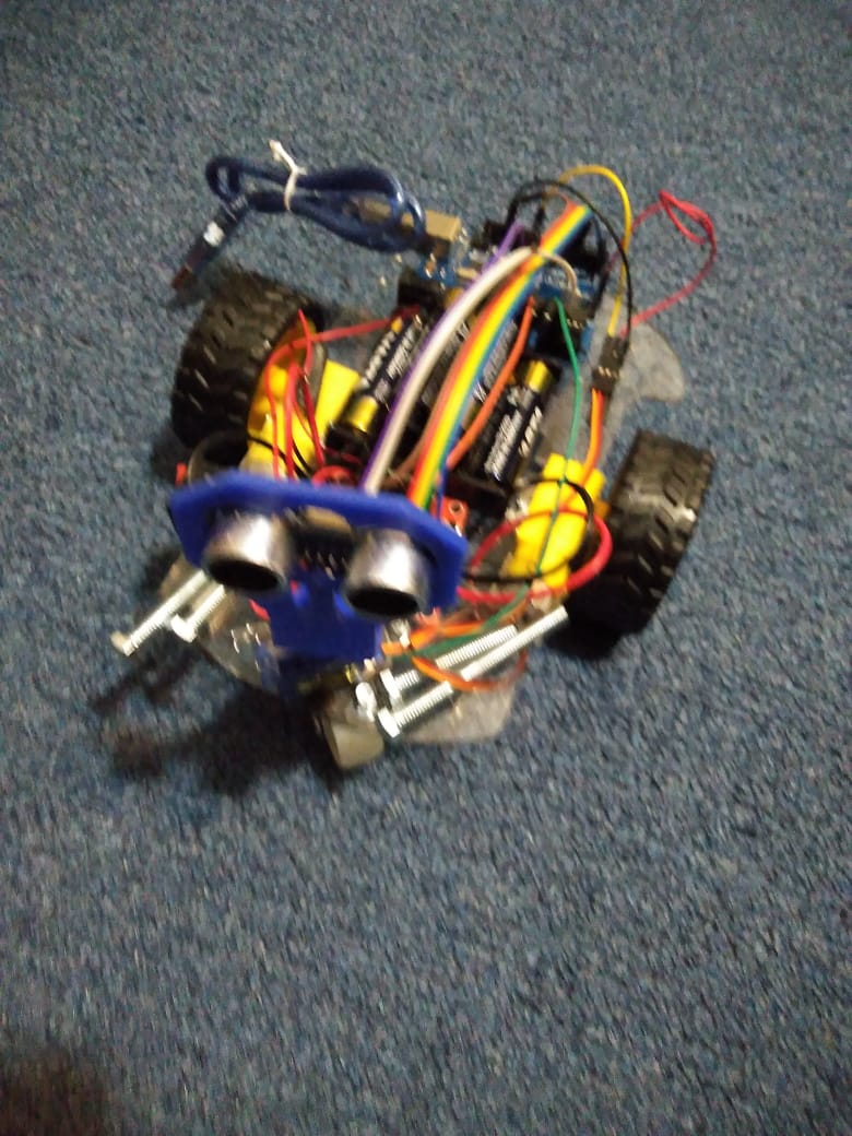

Hi Everyone,
I am making a simple 2w Obstacle Avoiding Robot using Arduino Uno, before assembling the Robot (car), i made a small code testing the motors and the motor driver (I used the l298n driver) and every thing worked smoothly, after assembling the robot and writing the code, i saw that the right motor isn't going backwards, I revised the code many times but didn't find anything to cause the motor not going backwards, I tried to invert the connections of the ports of the motor then it couldn't go forward. I searched in google but did't find anything that helped me in my problem, I don't know if you had or saw the same problem before but I hope you help me.

Welcome to the group.
When you try the sketch examples in the library do the motors operate properly ?
Show us a good schematic of your circuit.
Show us a good image of your ‘actual’ wiring.
Give links to components.

What is the voltage measured at the 5v pin on the UNO ?
Actually, it appears you are powering the UNO via the Vin pin, good, make sure the voltage is > 7v.
Then you are powering the sonar servo with the 5v pin on the UNO, this is bad, do not do this.

I know it is not good, but in the robot it self I am powering them from different vcc pins one from the 5v pin and one from the icsp pins on the Arduino board but unfortunately they don't appear in my sketch.
But they really work good, my main question is that why the right motor can't drive (go) backwards?.

You have Arduino 5v going to pin 8 of the 293 when pin 8 in the data sheet says:
“ Power VCC for drivers 4.5 V to 36 V”
Pin 16 on the 293 is:
“5-V supply for internal logic translation”.
pin 12 an 13 go to 0volts (GND).
To enable the two 293 drivers, pin 1 and 9 are to be HIGH, you can control these in software as needed.

Pins 12 and 13 are to be connected to zero volts, similar to pins 4 and 5.
Pins 1 and 9 should be connected to Arduino 5v, this will properly enable the driver logic.
Pin 8 connects to the motor supply, ‘do not’ connect it to Arduino 5v.
Pin 16 connects to Arduino 5v.

Thank you for your response, I figured out the problem, the block of the l298n was damaged (fried) because due to heating.
Because you wired pin 16 and 8 incorrectly ;).
