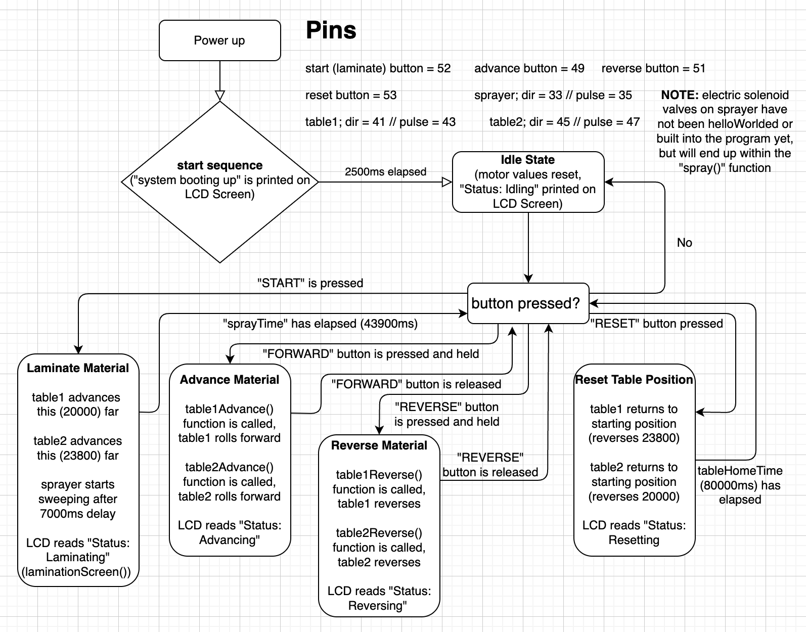

Howdy folks,
I wrote a little program for a lamination CNC machine that worked properly with some cheap, fake, TB6006 drivers from China. Code is posted below. I didn't change anything in the code, but I switched over to gecko 203V drivers and switched from my breadboard to a proper PCB. The LCD is working properly, but there is no motion. The motors are NEMA 23 bipolar stepper motors and I am using a 70.5k ohm set resistor. Does anyone else here have experience using Gecko Drivers (specifically) that they can lend to me? Any help is much appreciated. I do not want to have to disassemble my setup and hello world each part again, but I will if I absolutely have to.
Uploading: IMG_1552.jpg...

Code summary :
manual advance/reverse - two momentary pushbuttons to adjust the position of the material.
laminate functions - driveTable() and spray() happen simultaneously to pull a sheet through the machine and spray the material as it passes under the spray gantry.
reset function - brings the material back to the starting position if the spray is insufficient.

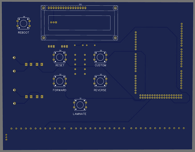

If You would post a link to the datasheet for that driver it likely helps.

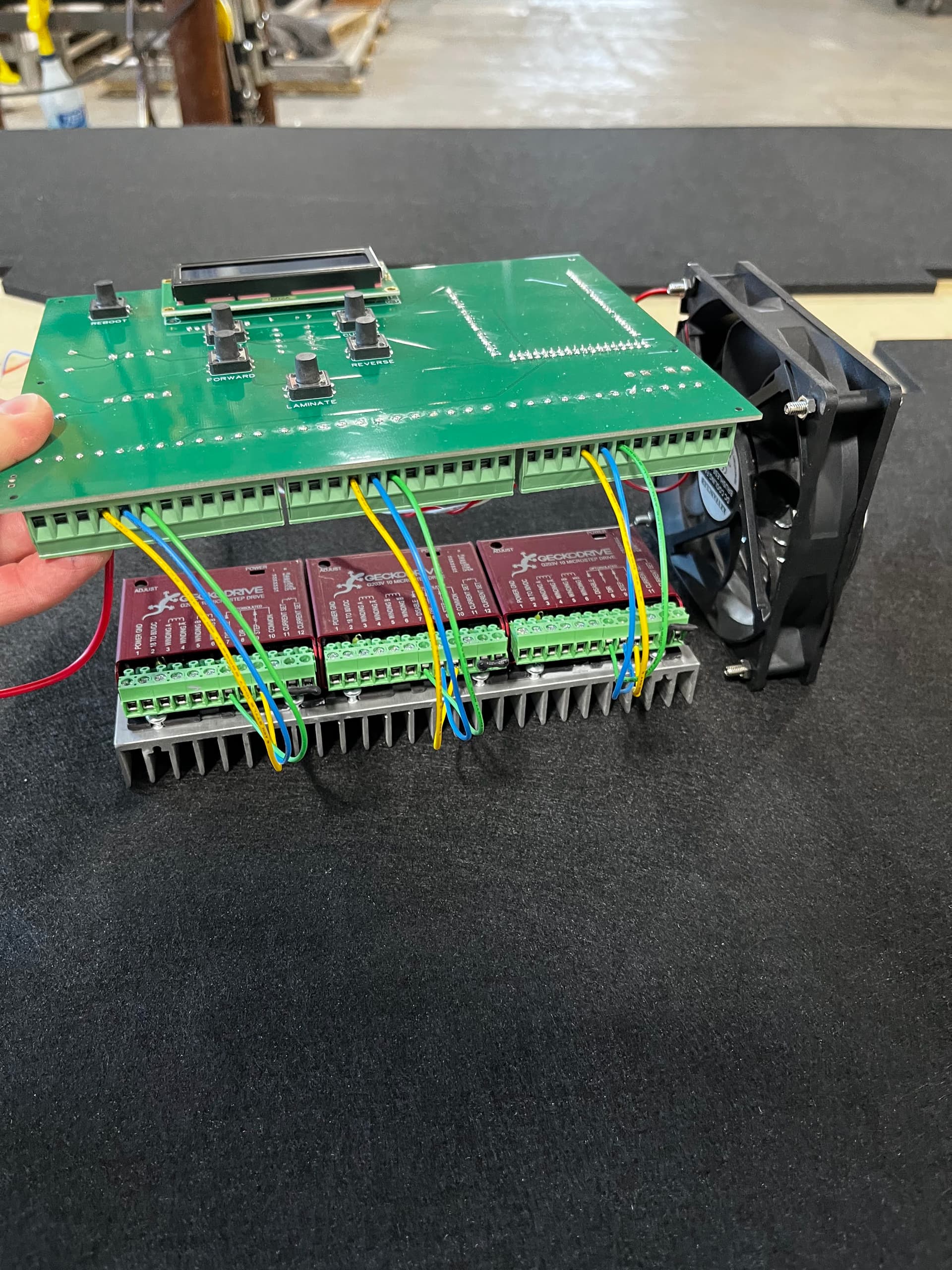

Lookin at the picture I can't see what logic You have connected. There are only 3 cables per driver and no motors.
If You send schematics it would help.
Do your debug prints tell you anything?
If it's wired as shown in your picture, you need Arduino ground to Gecko common.
no, sadly. I get no errors. It ran perfectly before.
i also noticed that and added common, it didn't change anything.
I didn't mention errors, I mentioned debug prints.
also, I realize my e-stop is not correctly wired up, but that's not my issue

I'd be inclined to grab a spare Arduino and one of the Gecko drivers and prove to yourself that you can use it to control one of your steppers.
I see that the Gecko is looking for a minimum of 18V, but in your diagram, I only see 12V. Do you have a separate supply for the motors?
yes. the gecko drivers are getting 36-50 VDC direct from a separate power supply. The 12vdc is to power a cooling fan and two electric solenoid valves
In most examples I see with gecko drivers, the driver's enable pin is written high. My drivers only have a disable pin. Is this the same thing? The manual says that if the enable pin is connected to controller 5v, it will stop the motors. Could this be my issue?
It looks like it I think.
I'm not currently doing anything with the disable pin. I did place a hand on the motors while running the machine, and even though there is no movement, I can feel a vibration. So something is happening, I'm just not sure how or what to adjust or play with from here. I took a driver off and tried it with an identical power supply and now it won't power up. Guess I will call gecko and report my findings back here after.
Vibration might mean you're trying to step too fast. Also, at that current you're going to need heatsinking apparently. It looks like you do, but perhaps the fan should be blowing along the vanes rather than against the side.
For sure. Everything is currently shoved into a cardboard box for the time being (same orientation as in the photo), just to get it functional and validate that it will work. Eventually I will be tig welding / water jetting an aluminum enclosure and 3d printing a faceplate for the interface (with more thoughtful placement of parts).
I'll start troubleshooting by trying everything at significantly slower speeds and whispering sweet nothings into the cardboard box. Will report back with findings.
I don't see how you have wired up the:
P1-Estop header
If you are using this in a non-hobby application, the wiring should be set up as a fail-safe.
The way your wiring is set up currently, and assuming that the E-stop is a simple 1-pole 1-throw, the disable pin is either floating or connected to ground via the E-stop.
I don't see where it is being controlled by the Mega.
If the disable pin is being controlled by the Mega, then your E-stop will not work to disable the controller unless you do some re-wiring.
"also, I realize my e-stop is not correctly wired up, but that's not my issue"
Yes, I am aware. I'm planning to sand off some solder mask on my power plane and tap into that (connected to Arduino's vcc), running a jumper from the power plane to the currently open (disconnected) pin on the e-stop header. Then I'm simply not going to use the PCB header pin that is connected to the ground plane, and connect the 1p1t e-stop latching button switch to the hacked vcc pin and the pin with all three disables connected. This way, when e-stop is pressed, all disables will get connected to arduino's 5v power, disabling the geck drives.
:+1:
