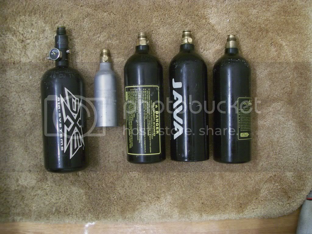

Insted of a blower (depends of what you wanna use) you can use a mini tank with compressed air because the blower gonna make extra noise and will not sound really good.
Pic. nr.1 Compressed air tank from paintball guns.
You can fill them easy with a extra valve from a gas station in the way you fill the tires.
After having all that, it's easy, connect everything pipes with plastic rubber pipes/network to the tank and servos to each sound pipe of curse you will need a electric valve to get the air outside the air tank, program the arduino and time everything in your order, wait the time and boom :smiley: you have a sound clock.
