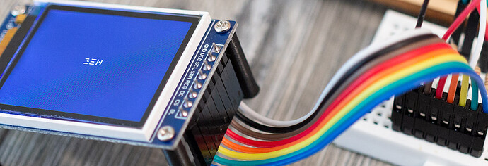

![test-bench_GEM_u8g2_hero_edited_1400](https://europe1.discourse-cdn.com/arduino/original/4X/2/7/7/277db2094dcb567f8b6014fd11ca2f50fd364918.jpeg)
Hey there!
Just updated [GEM](https://github.com/Spirik/GEM) to support [U8g2](https://github.com/olikraus/U8g2_Arduino) library for all graphics heavy lifting.
Short rundown of updates:
- Support for U8g2 library via `GEM_u8g2` class;
- Code cleanup (both **AltSerialGraphicLCD** and **U8g2** versions);
- Basic Cyrillic support for U8g2 version (`enableCyrillic()` method) with additional example sketch;
- New `reInit()` method to help reset display before returning from user-defined context;
- [Readme](https://github.com/Spirik/GEM) updates to include walkthrough guide on "How to use U8g2 version" and updated Reference section;
- Updated [wiki](https://github.com/Spirik/GEM/wiki) with [Initial setup](https://github.com/Spirik/GEM/wiki/Initial-setup) guide, [Test bench](https://github.com/Spirik/GEM/wiki/Test-bench-for-U8g2-version) wiring for U8g2-based example sketches and [How-to](https://github.com/Spirik/GEM/wiki/How-to)'s.
Updates available since [release 1.1.0](https://github.com/Spirik/GEM/releases/tag/1.1.0).

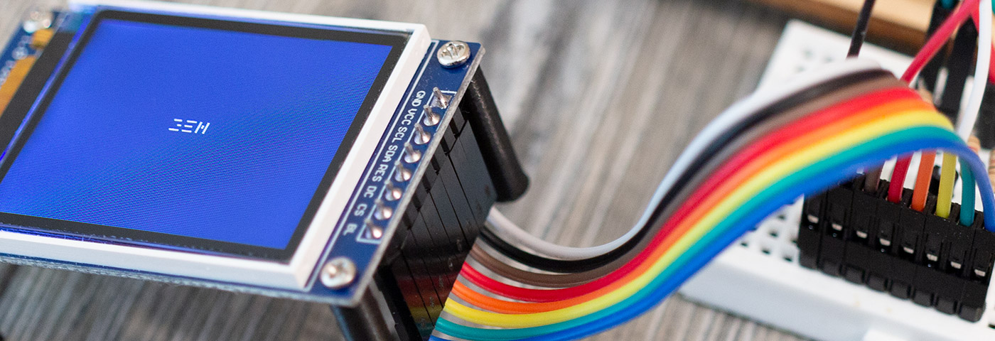

![test-bench_GEM_agfx_hero_edited_1400_v3](https://europe1.discourse-cdn.com/arduino/original/4X/7/4/5/74556f3449eb4de53f8f284bd5498a1209812e52.jpeg)
Hey there!
[GEM](https://github.com/Spirik/GEM) now supports [Adafruit GFX](https://learn.adafruit.com/adafruit-gfx-graphics-library) library, bringing ability to change color of the menu (on color-capable displays).
- Support for Adafruit GFX library via `GEM_adafruit_gfx` class;
- New `setForegroundColor()` and `setBackgroundColor()` methods to change color of the menu items and background;
- New `GEM_ITEMS_COUNT_AUTO` value for `menuItemsPerScreen` initialization parameter to turn on automatic calculation of number of items that will fit on the screen based on actual screen's height;
- Fixed minor bugs with `GEMItem::hide()`;
- [Readme](https://github.com/Spirik/GEM) updates to include walkthrough guide on "How to use Adafruit GFX version" and updated Reference section;
- Updated [wiki](https://github.com/Spirik/GEM/wiki) with [Initial setup](https://github.com/Spirik/GEM/wiki/Initial-setup) guide, [Test bench](https://github.com/Spirik/GEM/wiki/Test-bench-for-Adafruit-GFX-version) wiring for Adafruit GFX based example sketches and [How-to](https://github.com/Spirik/GEM/wiki/How-to)'s.
Updates available since [release 1.3.0](https://github.com/Spirik/GEM/releases/tag/1.3.0).

![custom-iconsGEMheroedited1400](https://europe1.discourse-cdn.com/arduino/original/4X/0/3/9/039aa0abd737e5b3f6f3ccda9fd6a98f1318cd04.jpeg)
Hello everyone!
Seems like it is time to give a small rundown of the recent GEM updates!
The most recent ones being:
- Support for custom icons: pass array of your sprites to `.sprites` property of `GEMAppearance` object (since ver. 1.8.0; see example on [Wokwi](https://wokwi.com/projects/464259857527523329));
- Support for `::drawSprite()` callback that allows even further icon customization of a specific menu item (e.g. certain button you'd like a custom icon for) (since ver. 1.8.0; see example on [Wokwi](https://wokwi.com/projects/464259857527523329));
See corresponding section on [wiki](https://github.com/Spirik/GEM/wiki/Custom-icons) for more details about Custom icons.
Sprites-related updates available in release [1.8.0](https://github.com/Spirik/GEM/releases/tag/1.8.0).
Previous updates include (among other things):
- Preview callbacks that are called in edit mode when intermediate values of associated variable is changed. It can be used to preview effects of updating the variable before saving it (since ver. 1.7.0; see example on [Wokwi](https://wokwi.com/projects/446631371931402241));
- `GEMSpinner` menu item for increment/decrement of numeric variables. Optional `loop` setting for selects (GEMSelect) and spinners (GEMSpinner) added to allow endless loop through the options (since ver. 1.6.4; see example on [Wokwi](https://wokwi.com/projects/410889496248755201));
- Non-interactive menu item `GEM_ITEM_LABEL` that displays basic text information (since ver. 1.6.3);
- Better support for menu traversing in user-defined callbacks and more methods to access state and properties of menu items (see example on [Wokwi](https://wokwi.com/projects/419142050690399233));
- Support for setting sprites 'magnification' size (i.e. scale factor) for Adafruit GFX version via `::setSpriteSize()` independent of text `magnification` size set via `::setTextSize()` method;
- Support for `::drawMenu()` callback that is invoked every time menu is drawn on the screen (since ver. 1.5.2; see example on [Wokwi](https://wokwi.com/projects/388726827759695873));
- `private` access specifiers changed to `protected` to make it possible to access internal fields and methods from within user-defined derived (inherited) classes, allowing to extend functionality of GEM;
- Optional "Advanced Mode" introduced, disabled by default but can be enabled via `config.h` or `GEM_ENABLE_ADVANCED_MODE` flag; when enabled some of the internal methods are made `virtual` to make it possible to override those methods in own sketch, allowing further customization and modification of GEM; more features of Advanced Mode may be added in the future (since ver. 1.5.2).
Fell free to check out updated [How-to](https://github.com/Spirik/GEM/wiki/How-to) section of wiki for more examples and usage tips.
Cheers!

![wiki_GEM_no_DICE_edited_1400](https://europe1.discourse-cdn.com/arduino/original/4X/c/3/e/c3e59e6ad0b10620871986c397c9b298ffb72d5f.jpeg)
I've created small showcase project called [no\_DICE](https://forum.arduino.cc/t/no-dice-arduino-based-dice-throwing-and-coin-flipping-simulator-with-3d-printed-enclosure/1466377) to demonstrate some of the features of GEM:
- Option selects and number value spinners;
- Buttons that launch context-based action (Dice, Coin, or Life app);
- Dynamic visibility of menu items;
- Custom icons (UI elements and individual icons for app buttons) via `drawSprite()` callback;
- Battery level icon and percentage value via `drawMenu()` callback and regular interval updates;
- Change of menu item titles based on chosen language (localization);
- Change options list of a select based on chosen language via new `GEMSelect::setOptions()` method.
Optional enclosure can be 3D-printed to fit Seeed XIAO RP2040 board, Grove Shield, clickable rotary encoder, and LiPo battery. This setup can serve as a basis for further experiments with GEM library.
