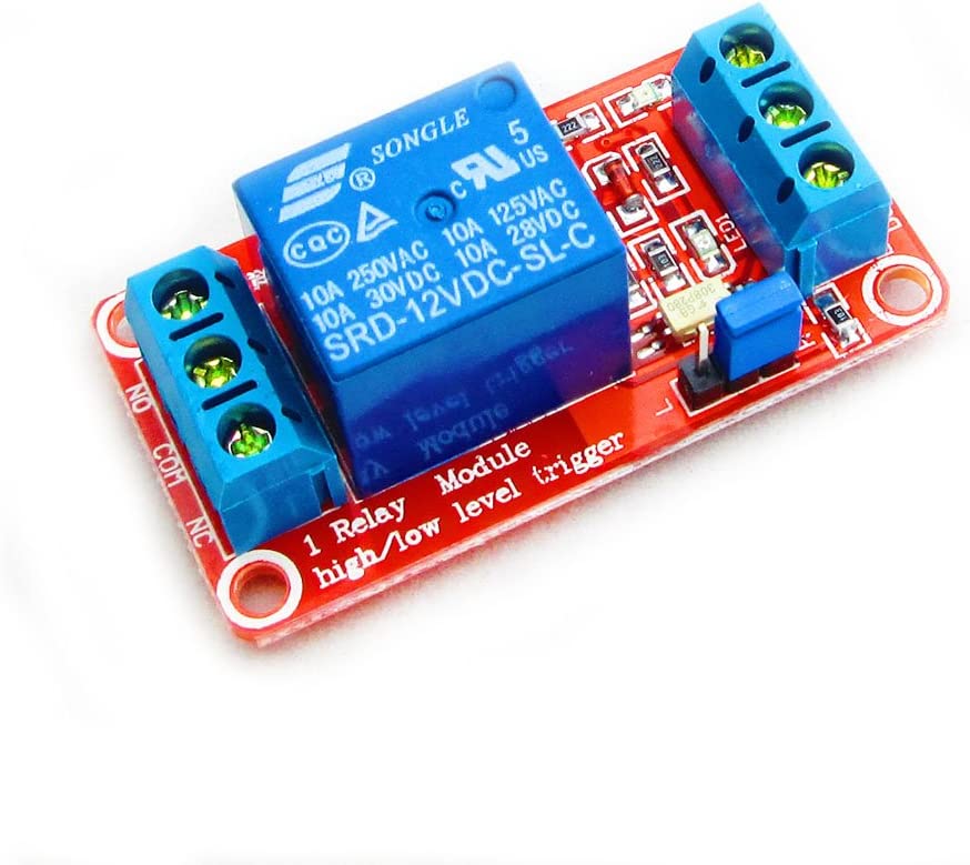

Yamaha rx-373 , could you give me an idea of what relay I need? I can probe inside the reciever to find a proper lead. Would this relay work? relay 12v | eBay
Likely as you don't need much. I also like the idea of using an opto-coupler as mentioned. This all begins with finding a signal in the receiver be it 12 volts, 5 volts or anything useable available when the receiver powers on. The PS_ON is not a matter of switching any current to speak of. While I never measured it we can figure any switch will work. This includes a simple opto-coupler. Just remember whatever you use for switching if a relay you need whatever the relay coil voltage is available. If the receiver has a 12 VDC line then a simple relay with a 12 volt coil or an opto-coupler will do fine. Nice thing about an opto-coupler isolation aside is you place a resistor in series with the emitter half so you can have a wide voltage range turn it on. There are several ways to get where you want to go.

So it sounds like one of these will work? Could anyone draw on it which wires would go where? Lead from receiver and green and ground from atx psu? I have never done anything like this before and trying to avoid trial and error with it… the inputs on the other side, from bottom to top are dc+ dc- and in
As said, try an opto coupler. Cheaper and far more reliable. No concerns that the load will be too heavy for your receiver or that it the coil will cause emf into your receiver...

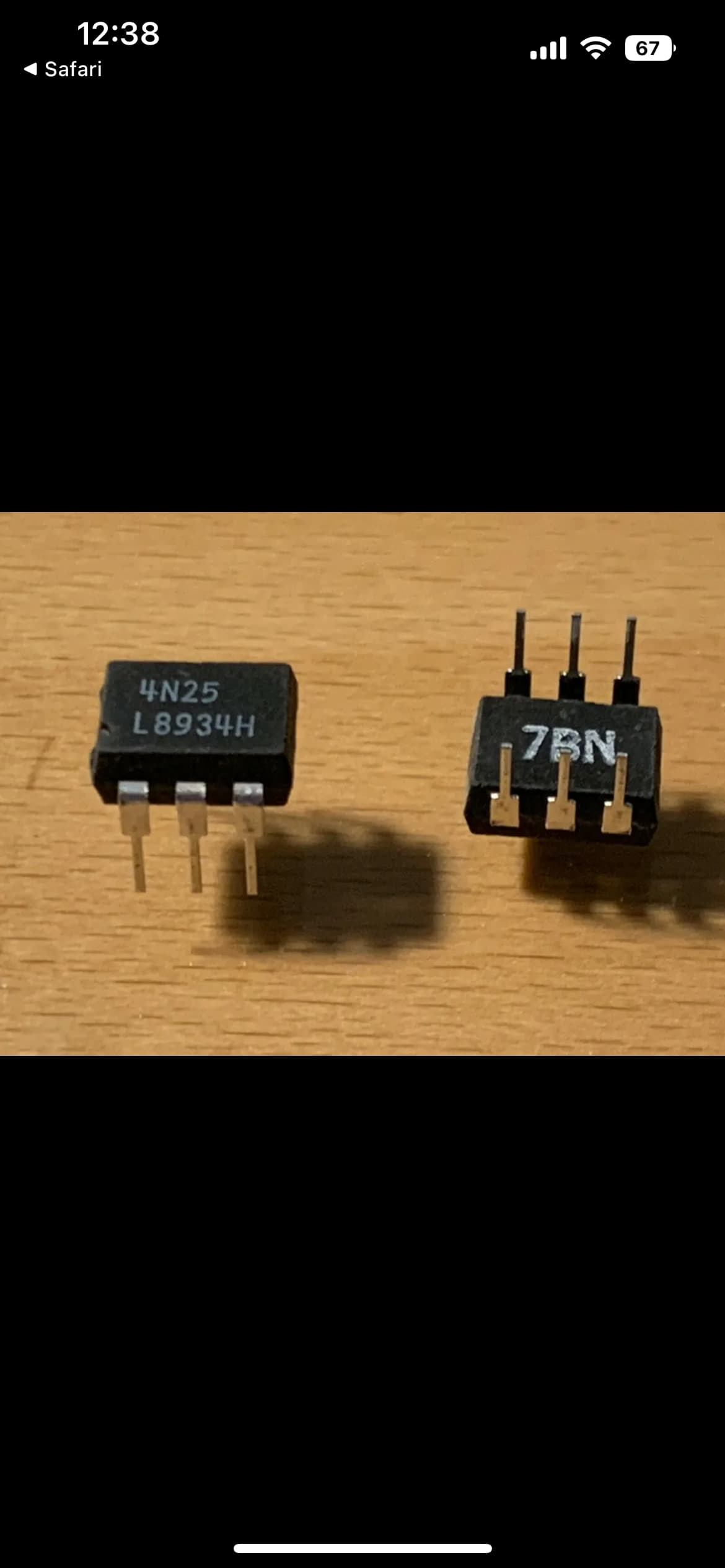

When I searched for octo coupler that is what came up. Could you link me an example of one? I know nearly nothing about this stuff. Was just last week I realized I can use an atx as a good 12v DC high amp power supply for something other than a PC…
You have found a relay with opto coupler.
Look for 4N25 opto coupler.
Ok, one of these? Could you help me on what connects where? Seems like I’m working with 3 leads. A power on from reciever and the ps-on and ground from PSU
Yes. Read the documentation...
Things that Google can answer should not be asked here.
If you cannot find it or do not understand the documentation, we are most willing to help...
