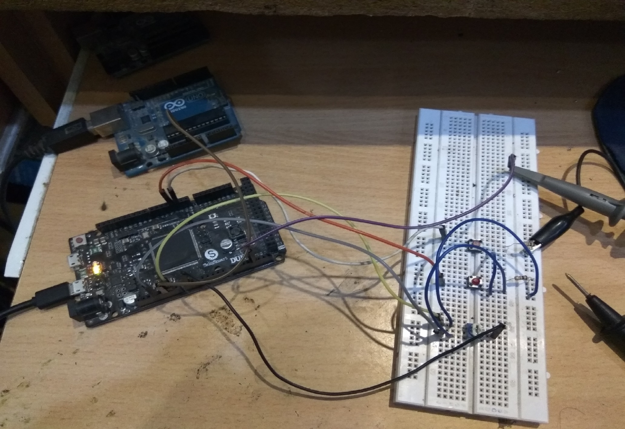

Hello everyone,
I working on a project, and i need a 2Hz, 100mV Peak-to-Peak signal, I'm using Arduino DUE and this Official example to generate the signal Arduino_Example I'm getting a 2.2 voltage at 2Hz in DC coupling mode on my Oscilloscope, I'm attaching images of it please have a look.
Please Help.
Thanks
Looks like it works. Congratulations.
So where does the 50Hz come in to the subject, or is that simply a typo error ?
A schematic, rather than a photograph of a breadboard (that, to be honest, isn't really showing anything) would useful
i need a 2Hz, 100mV Peak-to-Peak signal, I'm using Arduino DUE .................... I'm getting a 2.2 voltage at 2Hz in DC
So all you need is to put the output through a potential divider to bring it down to the 100mV that you want.
Out if curiously, what kind of things need this?
Yes! that was a typo, It is 2Hz
Yes! I used 1K Potentiometer at the Output and set it to 100mV, and this is working like a charm :slight_smile:
I'm making an ECG Simulator
Yes! it's working now :slight_smile:
Thank you for your comments
