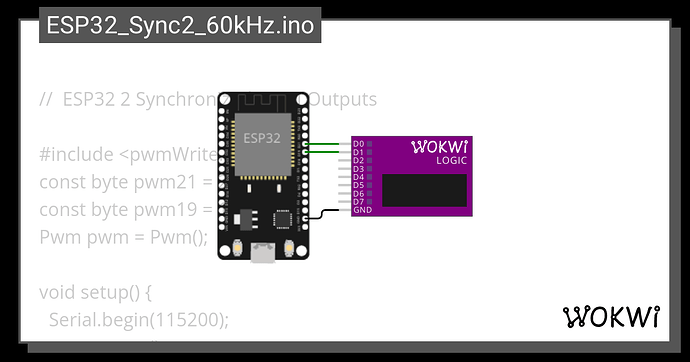

Did you know that when using ledc, the ESP32 has 8-pairs of pwm channels that are inherently synchronized?
Its simple to setup (this uses channel pair 0, 1) by default ...
Reference

I see you're using the same timer, which is good (maybe). Can't simulate on Wokwi because of an issue with the simulator.
I strongly suggest using a channel pair ch 0,1...2,3...4,5...6,7...8,9...10,11...12,13...14,15 to ensure
Jitter is within 150ns. If you inadvertently choose a channel that's on another timer, then the jitter will be up to several orders of magnitude worse!
For improved performance, use:
const int OutChannel1 = 0;
const int OutChannel2 = 1;
instead of:
const int OutChannel2 = 8;
Could also get better than only 8-bit resolution if needed.

Hi [dlloyd], first I have tried with channel 0 and 1. But it doesn't work. I always get the exact same signal on both pins. That's why I used channel 0 and channel 8.

You're using a version of Arduino Core for ESP32 that's too old. Its now at v2.0.9
