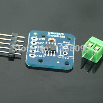

well i have a generic max31855K and i am using the adafruit max31855 library. it reads the internal temp correctly and with a reasonable temperature. However for reading the thermocouple it always reads something is wrong with the thermocouple.
I do have a adafruit 31855 v2 and i swaped it in for the other generic max31855K with the same exact code, wiring, and thermocouple and the adafruit works flawlessly any thoughts.
Note: i am using a unmodified adafruit library. and picture of the generic max31855k breakout in question is attached.
