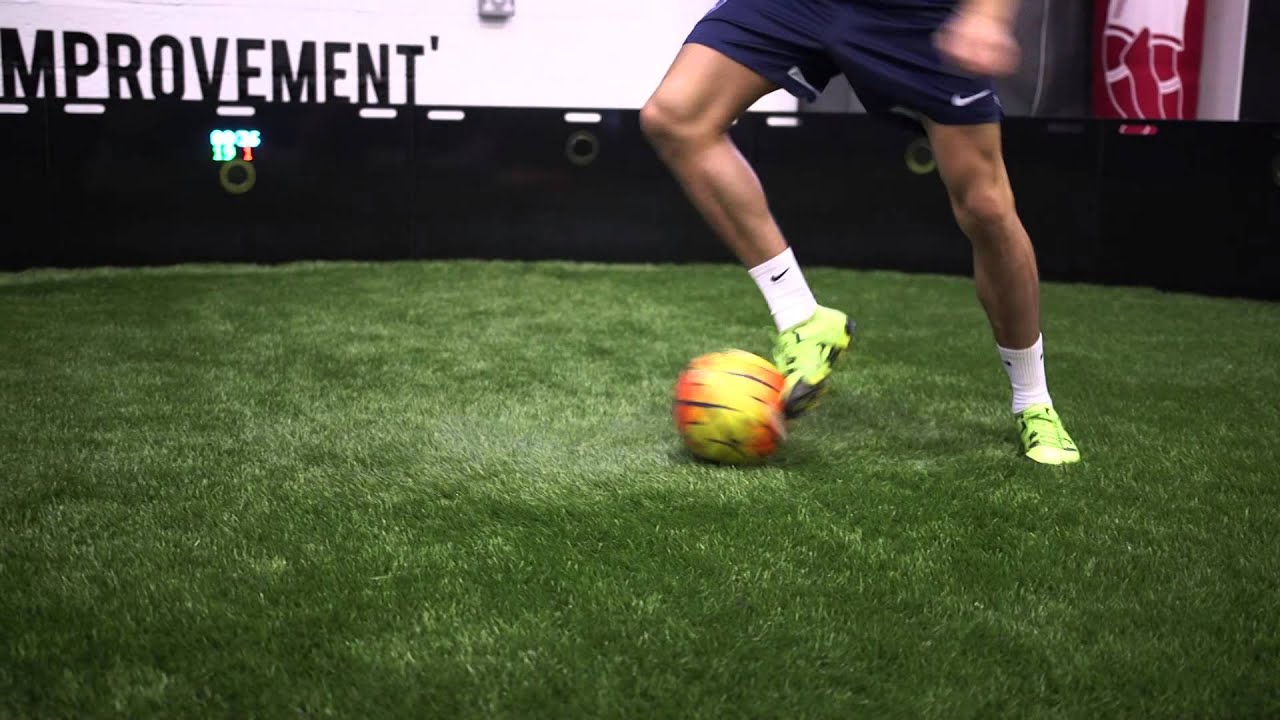

I want to make exactly this project!
Maybe it's easier to design single stand-alone panels, like they did in the video.
With cheap Nanos (up to 8 sensors per panel).
And daisy-chain them to a main control Arduino.
Leo..

You might not need multiple Arduinos for the soccer practice room. It looks like lawn care skills would be the biggest hurdle.
