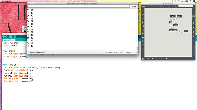

Get -1 from Serial.read
Hello guys, I'm sending two values from MaxMsp to Arduino, but the second it not read and is displayed with -1, why ? Screenshot attached.
How can I send these two int ?
Thanks
Albi
p.s. I'm reading as float into Arduino, but I've tried also with int and gives me -1 anyway.
Yes, in fact I can send n int to numero1, but not to numero2 that is always -1 ......because I need two separate values.....
 int number1;
int number2;
Serial.begin (9600);
if (Serial.available()) {
 number1=Serial.read();
 number2=Serial.read();
 Serial.println (number1);
 Serial.println (number2);
serial is slower than your mcu
it will detect a char in the serial buffer and process the first before the 2nd arrived.
when you read() and there is nothing in the buffer, it returns -1.
Delta_G:
You check to see if at least one character is available and then read 2. Why not check for 2 available?
if (Serial.available() >= 2) {
It works DeltaG!! Thanks a lot for your help!! Thanks also to BulldogLowell :slight_smile:
