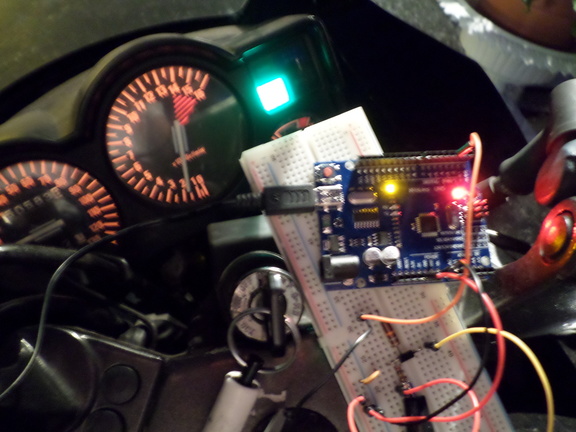

You'll have to look at the schematic for your particular vehicle, but something like the attached circuit is a probable solution. The switch is usually closure to ground, when closed the lamp is lit. To read the switch state you'd have a pullup resistor to Arduino power. The diode is to protect from vehicle 12 V having a path through the lamp to the Arduino input and +5 VDC. "Vout" is applied to a digital input to the Arduino.
@ MrMark - are you sure that the diode is the right way round?
Also that 10K resistor is in the wrong place. It won't protect the Vout from going to 12V.
Also using a catching diode like that is very poor practice for a permanent high voltage situation it is best suited for suppressing spikes.
The 10k resistor is a pullup for the switch, so ignoring the indicator lamp, the Arduino is seeing either a 10k pullup to +5 V or else it is seeing a switch to ground which is a pretty standard configuration.
The problem is when the switch is open there is a path from 12 V through the indicator light (modeled as ~100 ohms here) to the Arduino input. D1 is there to block that path so the Arduino input just sees the 10k pullup.
A more robust solution would be to have an additional series resistance to the Arduino input and a Zener diode to clamp the input as I've pictured in the attachment to this post, but the fundamental idea is the same as the previous post.

@Grumpy_Mike - I'm not clear on what you think is wrong with the circuit described.
On the chance that I was missing the boat, I prototyped the circuit described in the second post, minus the zener, tested it and it seemed to work as I'd expected.
The signal at the Arduino input pin held at 5V with about 50 mV peak noise on it when the neutral safety switch was open and was, of course grounded when the switch was closed.
I used ~20k rather than 10k resistors because that's what I hand on hand and the first diode I pulled out of the parts bin, albeit with a quick check that it would withstand 12 V reverse biased.
The Arduino was on USB power from an automobile converter with a common ground at the motorcycle battery.
The code simply read from pin 2, wrote that value to pin 13, delayed a second, and repeated such that the pin 13 LED followed the (green) console indicator light.
Noise peaks at input pin were observed by finding the highest trigger level on an analog oscilloscope AC coupled. Spikes were on the order of 5 us long. Frankly it was cleaner than I expected.
Gratuitous photos are attached. My apologies for the poor quality, but it was getting dark and the flash washed out the indicator lights so the shutter speed was quite slow. The "In_Gear" photo is particularly bad because it involves holding the running bike up while operating the clutch and taking the photo.
All that said, using an opto-isolator is probably safer than any direct attachment of the microcontroller to the bike electrics and the parts count is about the same.
