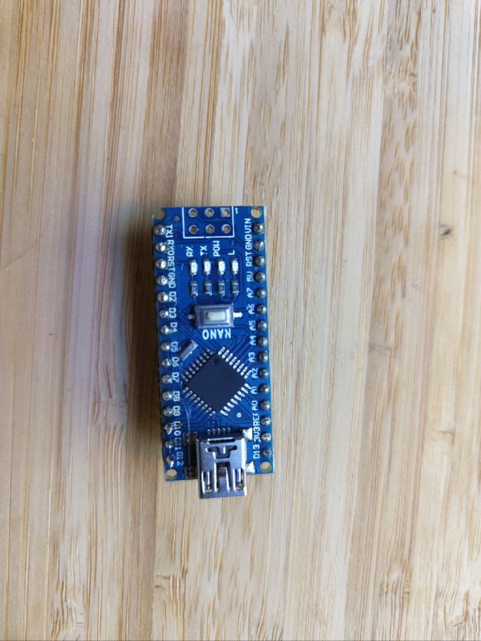

I have an Arduino Nano - I am not aware if this is a clone, I bought it cheap on ebay a few years ago.
**IMGUR - #5 Image**

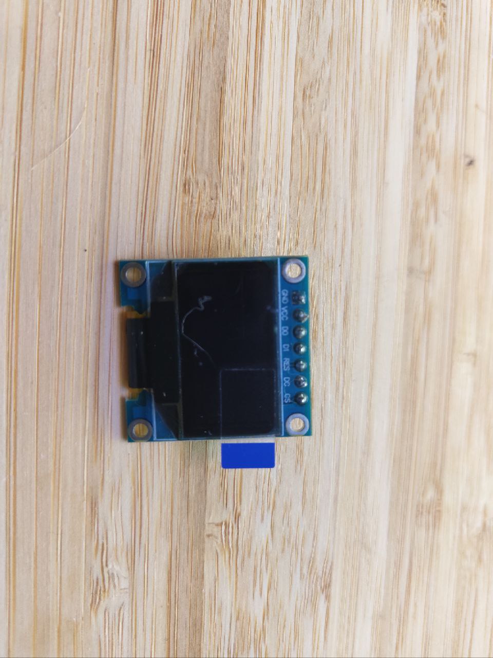

I also bought a tiny screen with 128x64 Pixels
**IMGUR - #6 & #7 Image**

Important: My Screen does not follow the same order (left-to-right) as the screen on the following Image from the tutorial.
My screen pin order is as follows (from left to right):
GND - VCC - D0 -D1 - RES - DC - CS

Now I need the data sheet for my Arduino Nano, i used the following:
**IMGUR - #1 Image**
With this information at my hands I wired the screen to my arduino nano the following way:
GND -\> GND
VCC -\> 3,3V
D0 -\> D10
D1 -\> D11
RES -\> D4
DC -\> D3
CS -\> D2

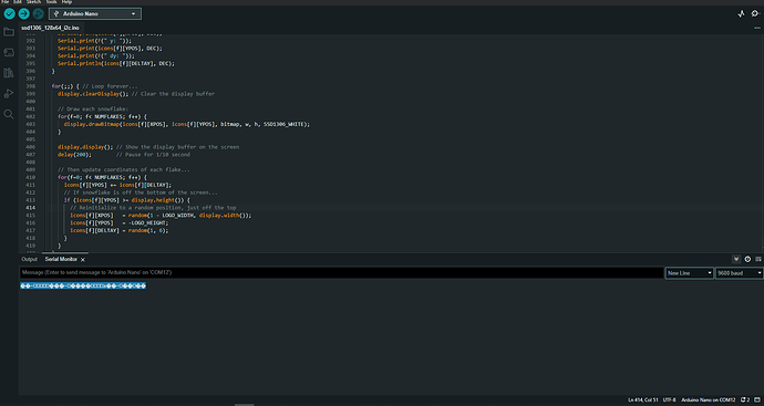

Afterwards I uploaded a slightly modificated sourcecode onto the Nano.
I'm basically using the example from File-\>Examples-\>Adafruit SSD1306-\>ssd1306\_128x64\_i2c and added the pin layout definition at the top.

There does not seem to be the output you mentioned.
 ![](https://europe1.discourse-cdn.com/arduino/original/4X/9/b/6/9b657b521733d6ae14694a8e4de409d2cce78ee5.png)

Oh, I'm sorry.
I am sadly limited to the amount of media I can post, I will post everything seperately.
 ![](https://europe1.discourse-cdn.com/arduino/original/4X/6/1/c/61cda21af208f640166406a118c99faf4dfd271a.jpeg)
 ![image](https://europe1.discourse-cdn.com/arduino/original/4X/f/a/c/facb674e9d8a91fd0114d2eaf8c77b8bffe0a85e.jpeg)
