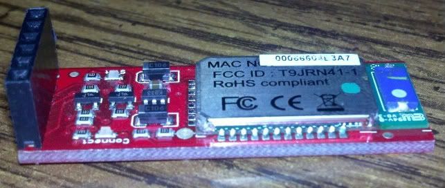

I want to communicate between the Arduino and my PC or a Phone but I can't get these modules to work. Imgur: The magic of the Internet
The problem with my BT module is that it has 8 pins, not 6, and is missingthe extra components. Compare the pics with this one

Ok, one more time.
Step 1.
FCC search FCC ID Search | Federal Communications Commission and get 6 pins module which you list above.
Step 2.
Google image search Google Images by your post image url an get Google Code Archive - Long-term storage for Google Code Project Hosting. and product name is Bluetooth Mate Silver from Sparkfun
Step 3.
Google search "Bluetooth Mate Silver Sparkfun", get Bluetooth Mate Silver - WRL-10393 - SparkFun Electronics and get ;-
Ok, we need Logic Level Converter.
Step 4.
Google search "Logic Level Converter Sparkfun", and get https://www.sparkfun.com/products/8745
Step 5.
have fun time!
So I have to basically build this right?
Yes, you answered your own question.
