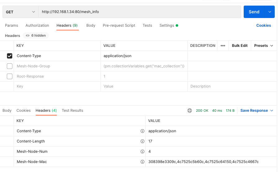

Hi. I have a problem with the http header
I am using following function to get the http header of the Mesh-Node-Mac, but I found the output of the http get header is 0.

I have use same url "http://192.168.1.34:80/mesh_info" in postman to check the result.
Postman can display the header as below.

Try printing out httpResponseCode after the GET. If it isn't 200 then something went wrong with the request and you can't expect the response header to contain your data.
It seems the request works since the JSON is printed out
The issue is with the 0 afterwards which I suspect is due to not caching the headers as they were coming in
@J-M-L Just found out that the collectHeaders is needed to call before the getting the header.
Changed to the following and seem ok now.
        const char *headerKeys[] = {"Mesh-Node-Mac"};
        const size_t headerKeysCount = sizeof(headerKeys) / sizeof(headerKeys[0]);
        http.collectHeaders(headerKeys, headerKeysCount);
        int httpResponseCode = http.GET();
        Serial.println(http.getString());
        Serial.println(http.headers());
        Serial.println(http.header("Mesh-Node-Mac"));
