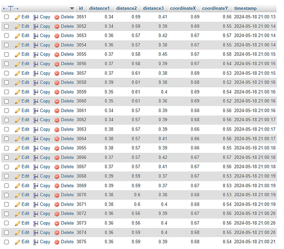

Good day, thank you for your reply. Ive been trying to gather the data to send back to you, but what the serial monitor shows it it looping through Adelay values (1-60k) for 30 minutes then settling on an arbitrary value. I did try to write code to loop through the 16550-16650 values for the adelay and output which had the most consistent values that fell in the range of +-10cm, but didnt have much success. It has been proven difficult to copy paste the 30 minutes of binary values for you to see, but today looking back on your link you did describe having his problem due to some misconfiguration between trojer's library and arduino modules. I knew i had downloaded your dw1000 module version but when i looked back on the ide it seemed to have recognized the 2 dw1000 libraries, but only used Trojer's version, which was the cause of my issue and i now can get an accurate Adelay.
A question of Clarification however, if i am to use the tag 2D_3A code for testing the anchor code im supposed to use is the "set_up anchor" , and just change "char anchor_addr[] = "84:00:5B:D5:A9:9A:E2:9C" to "char anchor_addr[] = "84:00:5B:D5:A9:9A:E2:80", 81 ,82... and so on?
Trojer's library had to be modified to make setting Adelay possible. The settings were just being ignored in your first experiment.
Change the leftmost byte. Little Endian.
Thank you, now changed.
Is the tag supposed to output the values obtained by the three anchors in some order of fashion? Currently is does recognize device 80-82 in the serial montor but, shows nothing else, even with this uncommented.

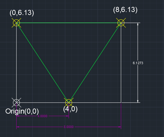

float anchor_matrix[N_ANCHORS][3] = { //list of anchor coordinates, relative to chosen origin.
  {0.0, 0.0, 0.97},  //Anchor labeled #1
  {3.99, 5.44, 1.14},//Anchor labeled #2
  {3.71, -0.3, 0.6}, //Anchor labeled #3
};  //Z values are ignored in this code
uint32_t last_anchor_update[N_ANCHORS] = {0}; //millis() value last time anchor was seen
float last_anchor_distance[N_ANCHORS] = {0.0}; //most recent distance reports
float current_tag_position[2] = {0.0, 0.0}; //global current position (meters with respect to anchor origin)
float current_distance_rmse = 0.0;  //rms error in distance calc => crude measure of position error (meters).  Needs to be better characterized

after the device anchor from 80 to 83, it currently work thank you. Some results seen below:
1, 0.77
d: 0.77 0.63 0.70
P= 2.10,2.66,2.68
3, 0.68
d: 0.77 0.63 0.68
P= 2.10,2.66,2.68
2, 0.68
d: 0.77 0.68 0.68
P= 2.10,2.66,2.66
Regarding your second question i do currently have them relatively close to each other (plugged into my computer) for ease of testing, so they are incorrect. I do plan to however use these in a building about 35-40 meters. I had planned to make a corner of the building be the origin point and make a triangle with the 3 anchors and measure the distance using tape measure and input the distance in meters as anchor 1,2 and 3 in the code. If my logic is flawed please let me know. A picture as an example is shown. Secondly in the tag code where the coordinates are, is anchor 1, 2 and 3, linked to a specific id ? eg anchor with address 83 is anchor 3 in tag code, or does that aspect not matter and i should just make sure they all have different coordinates?
Thanks again for your help.
Yes, "81" = anchor #1, "82" = anchor #2, etc. The coordinates you enter must match the ID and be in that order in the position array, as commented below:
If anchor #1 is at (0, 6.13, Z) then the first line of that array could look like this
  {0.0, 6.13, 0.0 },  //Anchor labeled #1 (Z value?)

These are results where everything was working properly
Hi.
I have currently followed all the steps and the work is fine. The problem is that when I try to use 2D_4A code with 4 anchors, it does not display anything. It detects the devices. Whenever I use 3 anchors, it compiles and displays data perfectly. What could be the possible reason? I am attaching the picture of output as well. Thanks in advance.
