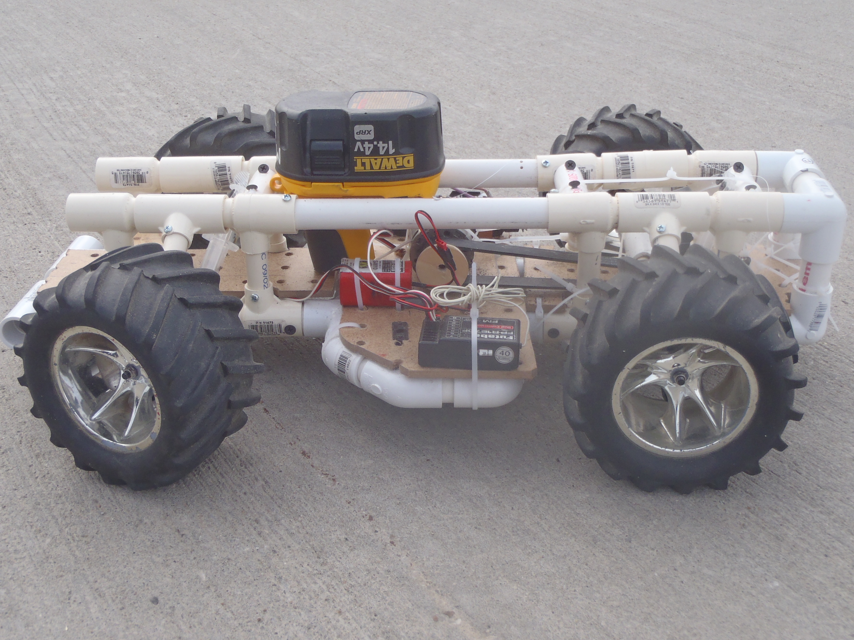

What you describe here is the basic outline of any decent hobby R/C car chassis; in fact, you might look into such a chassis, or at the very least - the mechanics and setup of how such a chassis is built, and how the servo is connected to the steering (known as "Ackermann Geometry").
banditojosh1997:
2) Yes, I need the 12v DC motor to be able to change speed.
  1. Yes, I need the DC motor to change direction (rotate clockwise and counterclockwise).
Then you have a couple of options - you can go with an h-bridge to drive the motor (spec of h-bridge will be determined by spec of motor, which you haven't yet provided to us) - or, if you go with a pre-built hobby R/C car chassis (or parts), you can use a brushed (not brushless) ESC (electronic speed control).
For the former method, you would need to develop your own control routines to activate the h-bridge and control the speed (via PWM); for the latter ESC method - you would simply need to use the Servo library (an ESC will typically have some form of "arming" sequence that you will have to code for using the library; the sequence will be detailed in the manual for the ESC).
banditojosh1997:
4) It would be preferred to be able to have the servo be able to rotate the full 180 degrees, but even if its able to turn a little, that would be enough for my steering purposes.
Most servos will do 180 degrees using; many will do much more (270 degrees or so, which is about the limit of a standard potentiometer used for feedback in the servo). You may need to play with the Servo library to get it to work properly, but it shouldn't be an issue. As a matter of fact, for steering using Ackermann geometry, the servo arm only really needs to move 45-60 degrees or so; again, look into the geometry and into how hobby-grade R/C vehicles are built.
The reason I mention hobby-grade R/C vehicles as a platform for your needs, is that they are readily available, and are very easy to control with an Arduino (just use the Servo library, as I mentioned earlier); the downside of such a platform is their cost (they can be pricey).
If cost is an issue - then simply studying how they are built, etc can get you along to a point where you can build your own chassis (or use a cheaper "toy-grade" RC car chassis), outfitting it with your motor and servo to control the vehicle. An example:
