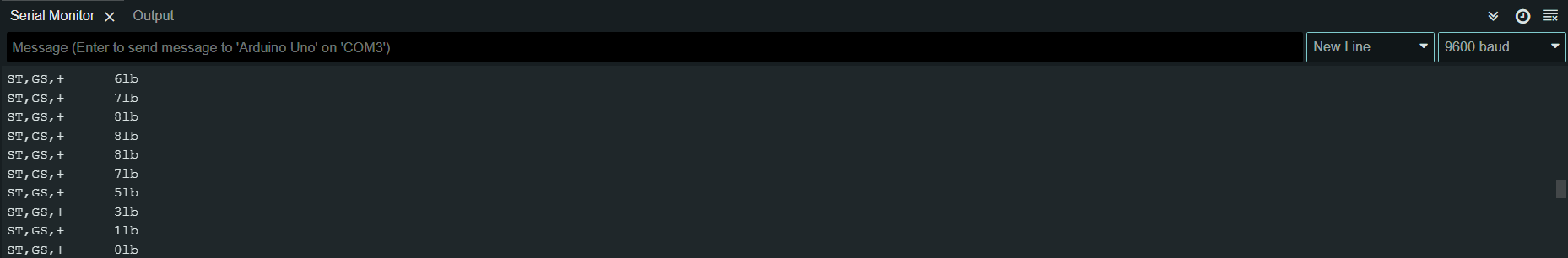

I'm working on a project where I need to collect data from a load cell using the serial monitor. I can collect this data fine, the problem is that it comes with some random letters before and lbs after. I want to change this data from a char value to an int so I can just collect the numerical data and use that. The problem is I cannot find a way to print the data other than using the char variable type. Can anyone help? I will list the section of code that I use to collect this below.

Please also post an example of what is printed
Thanks for the help. Here is an example of my code along with a picture of the serial data I receive. The data itself is all good, but I want to be able to extract just the numbers.

Try this
    if (Serial.available())
        int data = THRUST.parseInt();
        Serial.println(data);
Do you have any control over the format of the data being sent ?
I changed Serial.available to THRUST.available and it worked for me! Thank you so much, I was messing around with the parseInt function for hours with no luck. Do you know how I can take this data now and print it on an LCD? I tried like this but it doesn't let me use the 'data' term to display it.

The data variable is declared inside the code block of the if function so its scope is limited to that code block
Try this
  int data;
  if (THRUST.available())
  lcd.clear();
  lcd.print("THRUST");
  lcd.print(data);
That worked perfectly for me. Thank you so much again for your help. I'm very new to using Arduino and have been searching for a solution for hours so I appreciate it a lot.
