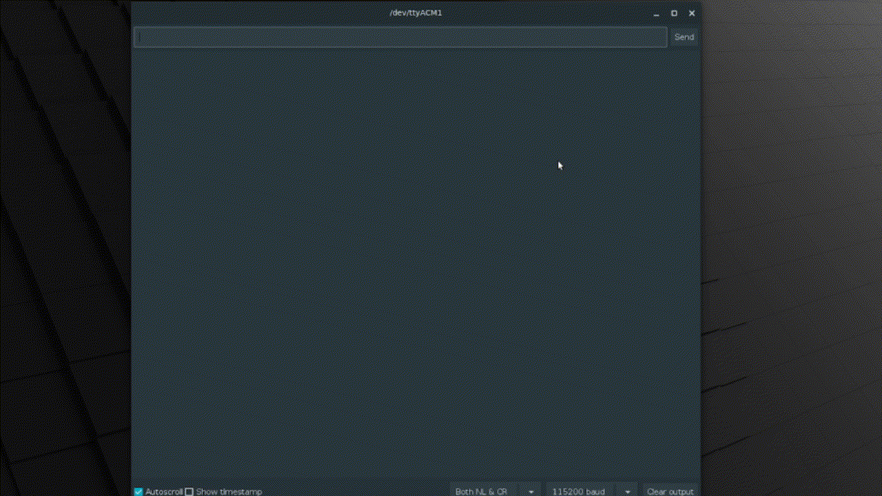

It does work... Did you remember to change the "localName" to suit your application. In the example it searches for any device with the name "LED". In my animation below, I changed my local name to "Pico" as my peripheral was a Raspberry Pi Pico board running its own custom BLE example.
  // check if a peripheral has been discovered
  BLEDevice peripheral = BLE.available();
  if (peripheral) {
    // discovered a peripheral, print out address, local name, and advertised service
    Serial.print("Found ");
    Serial.print(peripheral.address());
    Serial.print(" '");
    Serial.print(peripheral.localName());
    Serial.print("' ");
    Serial.print(peripheral.advertisedServiceUuid());
    Serial.println();
    // see if peripheral is a LED
    if (peripheral.localName() == "LED") {
      // stop scanning
      BLE.stopScan();
      explorerPeripheral(peripheral);
      // peripheral disconnected, we are done
      while (1) {
        // do nothing
Giga_PeripheralExplorer
