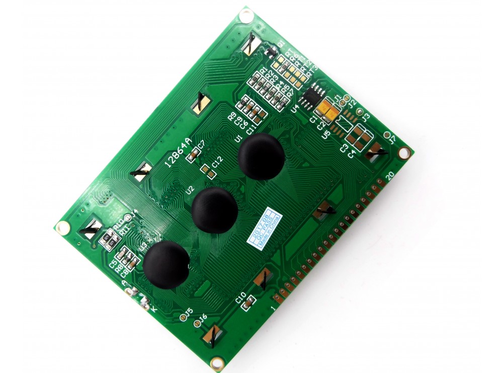

i attach picture glcd in this topic

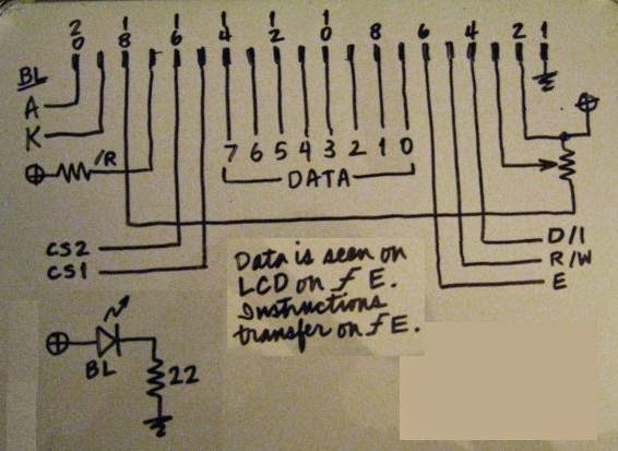

I can't say how illuminating this sketch will prove. It's not a "library", it's just what I came up with while experimenting.

The /R pull-up is 1K. The pot is 50K.
