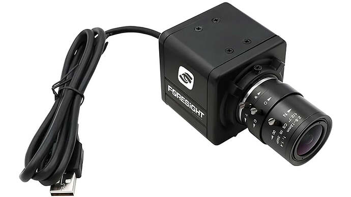

> [@ambbojsen93](#):
> rotation, accelleration, twist/torgue and swing plane
All these can be measured with a high-frame-per-second camera. What remains can be calculated using mass and rotational velocity.
> **[Foresight USB Golf Swing Camera](https://aceindoorgolf.com/products/foresight-usb-swing-camera)**
> Get down-the-line or face-on video of your golf swing with a Foresight USB Swing Camera. Analyze a swing in slow motion.
 ![17545878795652926529408444463616](https://europe1.discourse-cdn.com/arduino/original/4X/0/a/e/0ae58a1172cfbc4129e682b8f63f6f8710f6f0fa.jpeg)
