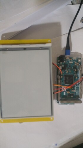

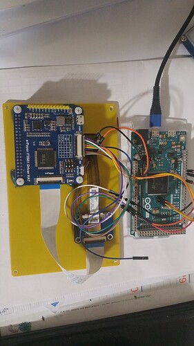

Hello,
Thanks for adding IT8951 Driver HAT on Due in GxEPD2
But I can't find the specific lines for the Arduino DUE (ARM)
I share in photo the assembly this screen 6" with IT8951
I used the command line:
GxEPD2_BW <GxEPD2_it60, GxEPD2_it60 :: HEIGHT> display (GxEPD2_it60 (/ * CS = 5 * / 10, / * DC = * / 8, / * RST = * / 9, / * BUSY = * / 7)); directly . It works very well with example.
But I did not connect the Dc wire to position 8 which does not exist in the SPI connection of the IT8951
This IT8591 Driver Hat is also used for 7.8 ", 9.7", 10.3 "screens Waveshare, Would it be possible to also use these screens by adding them to the GxEPD2 library because they are also very interesting?
Thank you again for your work in using these screens
Jean-Claude
@claudius310,
I had to put on my glasses and look twice to verify that this line is really there in GxEPD2_boards_added.h at line 62.
A famous Tesla Member might tell you to "put on your glasses" in such a case.
But I have to refrain from this, because I would risk that a moderator might alter my post, as has happened.
Yes, this would be possible. Note that the IT8951 Driver HAT needs be bought together with the panel, as it comes programmed or parameterized for the matching panel.
It may be enough to adapt WIDTH and HEIGHT in GxEPD2_it60.h for a test.
For supporting these other combinations in GxEPD2 or GxEPD_HD I would need a sponsor or donator.
See line 86 of README.md:
[color=#6ea657]###[/color][color=#608b4e] I can and will only support e-paper panels I have![/color]
- promotion panels from suppliers are welcome, to add support to GxEPD2
- donation panels from users are welcome, to add support to GxEPD2
Note that ED060SCT on IT8951 Driver HAT is also supported by GxEPD_HD, providing grey level graphics. See:
https://forum.arduino.cc/index.php?topic=487007.msg4777906#msg4777906
Jean-Marc

@claudius310,
I don't like to argue. I have decided to not answer posts I don't like. But already it seems I need to make an exception.
https://forum.arduino.cc/index.php?topic=436411.msg4751132#msg4751132
in this post you had found where to put that line.
I need to specify a value for the DC parameter. I chose the same value as my DUE shield uses for other EPDs.
You can use -1 to avoid that a pin is used.
Lines 26 and 27 of GxEPD2_it60.h are:
    static const uint16_t WIDTH = 800;
    static const uint16_t HEIGHT = 600;
I don't want to share any account information. If any one wants to donate hardware, just tell me and I send my address in a personal message. Shops on AliExpress can deliver to any address, other shops should be able, too.

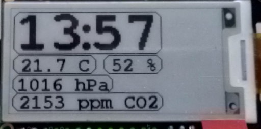

Hi!
I toy around with a TTGO/LLGO LilyGo_T5_V2.3 250x122 epaper display. I use GxEPD, display uses the GxGDEH0213B73.h controller and works totally fine with full update() but looks shitty with partial updateWindow().
I played around with window sizes, align to (%8==0) sizes, but obviously I'm fishing in the dark.
Any ideas?
Hi hole,
the physical x direction of your display is the short side of the panel.
The start and width of a partial window should be a multiple of 8 in the physical x direction, else it is increased.
That's all I can tell with the limited information you provide.
But I should add this: with GxEPD you need to do an initial full update followed with a partial update of the full screen, before you do any partial window updates. The controller of the GDEH0213B73 has a quirk that makes this especially important. This is handled automatically in GxEPD2.
I recommend GxEPD2 for new users or new projects. It is also available through Library Manager.
Jean-Marc
Thanks Jean-Marc, for the fast response.
I do a full update at startup:
  display->init();
  display->setRotation(1);
  display->fillScreen(GxEPD_WHITE);
  display->update();
Are there any infos I can provide?
ZinggJM:
But I should add this: with GxEPD you need to do an initial full update followed with a partial update of the full screen with the same content, before you do any partial window updates. The controller of the GDEH0213B73 has a quirk that makes this especially important. This is handled automatically in GxEPD2.
Yes, the complete code, in a code window, please.
