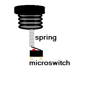

This would be a simple fix let a spring hit the microswitch The spring would let you over tighten the cap and not break the microswitch.
And could easily be setup to insure you have tighten the cap
