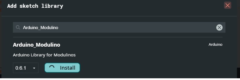

Same here. And no error message. The button shows "installing" for 2 seconds and then return to "install".
Is there any other way to install a library?

Recently, the Modulino library was renamed Arduino_Modulino (see Update name of "Arduino_Modulino" by per1234 · Pull Request #7119 · arduino/library-registry · GitHub). The library Modulino no longer exists, and it is called Arduino_Modulino.
To solve the issue, you need to install the Arduino_Modulino (and remove the Modulino) library.
You can install it by following the instructions below:
  • Open the App with Arduino AppLab
  • Click on the “add library” button in the libraries section on the left
  • Type Arduino modulino in the input box
  • Click install button (version 0.6.1).
  • Start the App
NOTE: For a missing feature, it is not possible to remove the old Modulino entry from the sketch.yaml file using the ArduinoAppLab.
For doing this, you could use adb or ssh (https://docs.arduino.cc/tutorials/uno-q/ssh/) and remove manually the - Modulino (0.5.0) line from the sketch.yaml

I'm sorry to cause any trouble, but I just can't use the modulino modules. If I go to SBC, can I manually install the libraries?
Yes, even if not recommended, you could manually edit the sketch.yaml.
You can find your apps in the /home/arduino/ArduinoApps/<your-app>/ location.
Just stop the app, open the /home/arduino/ArduinoApps/<your-app>/sketch/sketch.yaml file with a file editor and add the line - Arduino_Modulino (0.6.1)
you may add also other deps manually

But this library does not install, same as with the old Modulino lib.
When you click on "install", the circle appears for 2 seconds and the button changes back to "install" again.
My sketch.yaml looks like your example
When I click on run:
Sketch profile configured: FQBN="arduino:zephyr:unoq", Port=""
Task Downloading library Arduino_Modulino@0.6.1: 0.00%
Task Library Arduino_Modulino@0.6.1 not found: 0.00%
Error: code:9 message:"Library 'Arduino_Modulino' not found"
Tried with and without underscore between "Arduino" and "Modulino".
Any hint on manually fetching the lib is appreciated.
And the most annoying part:
https://downloads.arduino.cc/libraries/github.com/arduino-libraries/Arduino_Modulino-0.6.1.zip
exists and can be downloaded with the browser...
Is there a more verbose mode or a log that could help you in figuring out what's wrong here?

Could you try to run this command from a terminal inside the board?
arduino-cli lib update-index
and then try again to run the app (with the Arduino_modulino (0.6.1) into the sketch.yaml).
Nice, now it downloads the 0.6.1 lib...thanks.
