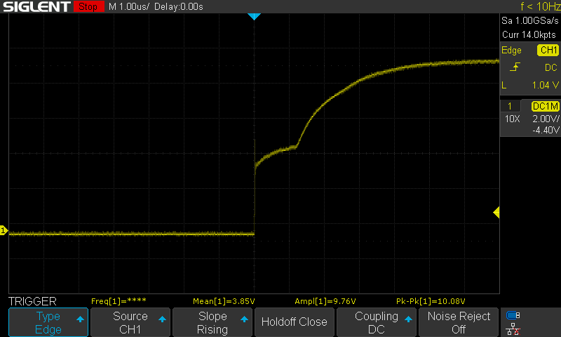

So, I tried the last video that you posted @LarryD , but maybe im doing something wrong? It doesnt seem to be working.
This is what my o'scope displays (I used the print function @EmilyJane :wink:):
I have my probe attached to a 47Ω resistor and the end of a spool of wire. The GND clip from the probe is clipped to the negative terminal of a new 9v battery. I then tap the end of the resistor on the positive terminal of the battery just like in the video, and the o'scope displays the picture above.
Possible reasons:
I dont know what im doing exactly on the o'scope (although I think I set everything correctly)
I used a 47Ω resistor as I do not have a 50Ω
the wire is 20awg on a spool instead of a straightened coax cable
Im using the probe that came with the o'scope instead of a direct bnc connection
This needs to be 2 strands, i.e. not a single strand of wire on a spool.
example:
twisted pair Cat6.
Oh. How did he test a single strand coax cable? My spool is actually 4 strands; is that fine? I am only connecting everything to one of the strands, and the other end is open.

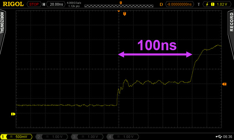

Here is a quick test on Cat5 cable, W/Gn pair; about 34 feet.
(100ns * .983 * .67)/2 = 33 feet

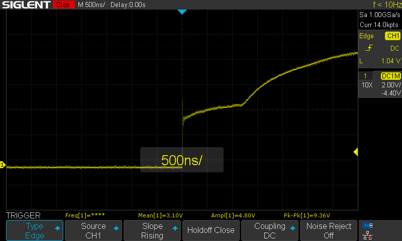

So, I tried attaching the ground wire in my cable to the end terminal of the 9v battery, in addition to what I already have. After zooming out quite a bit, I get this:
Is that what it should look like? Based off of that, this spool is 392 feet (I'm not sure how long it is besides that; no info on the spool at all).

Measurement:
(1190ns * .983 * .67)/2 = 392 feet

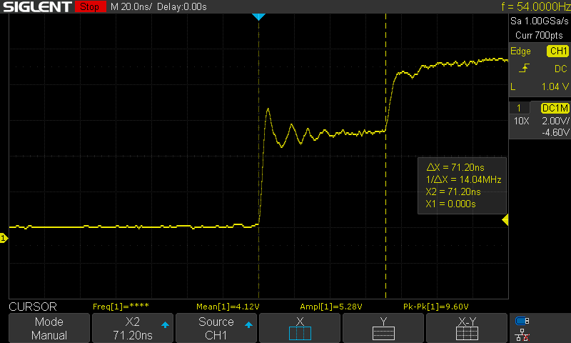

Successful measurement of an extension cord:
That makes it out to be 23.5 (24) feet long :smiley:.
