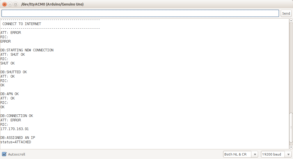

I’m trying to get gps position and send to my API through the shields Gprs SIM900 and Gps NEO-6M.
On setup(), first I start gprs shield and call the function that connects to internet. Then on loop(), I start to capture gps position and finally I sending to api, but my code don’t work with this logic. I’d like connects once and get gps coordinates and send to api many times making a tracking.
The app stops if I run the code. connectToInternet() on setup() and getGpsPosition() loop(). The shield SIM900 connects but the shield NEO6-M does not display the coordinates. The GPS only capture the coordinates if I do not connect to internet.
Could someone help me? Following is my code and print of the response AT commands.

If I connect to internet the GPS does not display the coordinates
But, if I don’t connect to internet the GPS display the coordinates.

I solved.... https://github.com/robsonfagundes/Arduino-GprsSIM900andGpsNEO-6M This example also serves to help other developers who are facing the same problem or a similar problem with Gprs SIM900 and Gps NEO-6M working together.
