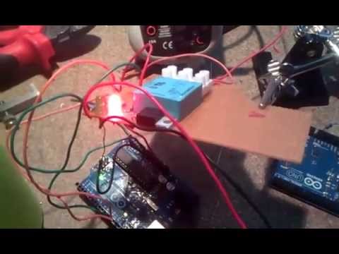

hoi ,mirith
i have this one on my boat
arduino Water Leak Detection Alarm
i prograam it if the boat al has a lek the pump is going to on
