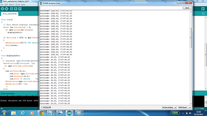

Now about 3/4 down I have commented a line with "this caused the problems". when the line is disabled, the serial monitor prints the altitude correctly. But when it is enabled, the serial monitor simple prints the altitude as "0.00".
I can't work out why the lcd print function affects the altitude value stored and printed via serial.

I could provide a screen shot of the serial monitor showing 0.00 as per the original post if you want?
And the other question you posed: Exactly my point, as per the first post.

Ahh that's good to know. I thought I had it fixed by only ever calling the function when it is confirmed as valid, but the error has now reappeared. :confused:
I appear to have isolated the problem, and it appears to be how the value is printed.

But when I enable the two commented out lines, after about 5 minutes or so the altitude value on the serial port and lcd will change to around 25.0. and sometimes 17.2 as per the attached screenshot. It's weird. My only theory was that the extra delay of printing to the lcd could allow the value to become corrupt before it is read. So I moved the 'metres' print bit and set cursor to before the 'if valid' bit, and now the serial monitor reads INVALID for a few minutes before changing to 0.00. the LCD shows " metres" (5 blank characters then metres) indefinitely.

I just can't figure it out, why can I print the altitude perfectly (1275.90) on the bottom line of the lcd), but when I add the word 'metres', it stops it working?

dave_sausages:
The altitude here is approx 1270 metres. All of this is being done while outside in an open area with miles of Utah sky above me.
That doesn't answer my question. It only means you're confident that the GPS couldn't possibly be reporting odd altitude values, not that it isn't. It's a simple matter to display the raw data.
/dev:
This may be why the altitude goes from 1266 to 25. Maybe it's dropping the '1'?
And still get a correct checksum? That seems unlikely. It's why I think it's worth echoing the actual NMEA strings to the serial monitor, as a sanity check.
Oops, I meant "dropping the '1's" from 1251, which would still pass the CS test. It is unlikely, though.
In the screenshot, there are (at least) 4 sentences per second, and the altitude doesn't change for several seconds before and after. That seemed to imply CS errors, as the altitude should have wandered if the sentence CS was ok. It looks like the GGA, the only sentence with altitude, is the 3rd or 4th sentence in each second. If there are lots of errors, then a double error is certainly possible, and the NMEA CS isn't very good for multiple errors.
The time is correctly updating, so at least the first 4 sentences in every interval don't have errors, which makes sense. He might start getting errors because the "Altitude" prints are 25 chars/sentence. which would cause it to block at Serial.print during the 3rd sentence. It looks like the 3rd or 4th sentence (not a GGA) gets dropped in interval 45, and then the time changes. These prints clear out at the end of the interval, perhaps causing the same set of errors every second.
The NeoGPS example sketch displays the Sentence Count, CS errors, and Chars Received, which would have been unambiguous. The sketch I provided defers printing to the GPS quiet time, which would certainly change its timing.
As you said, example output would be best.
