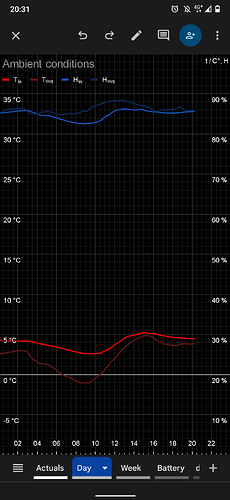

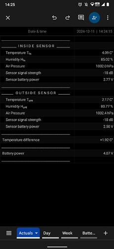

I thought, it would be nice to somehow see how warm or cold it gets over the year. As I can get Ruuvi tags for free from work, I was looking for a convenient way to read their data without having to walk out with my phone and then learned about ESP32 microcontrollers.

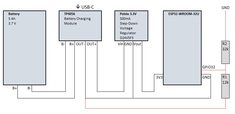

The hardware is wired as follows - I am using a 5 Ah LiPo battery that I also got from company trash, which I can charge via a TP4056 charging module/USB C. The ESP32 itself is powered by a Pololu 3.3V voltage regulator:
 ![image](https://europe1.discourse-cdn.com/arduino/original/4X/3/a/7/3a782bb1d10b85d4efb0bd4b74f03af95d2263ac.png)
I can check on the battery level by measuring the battery voltage on an analog IN over a voltage divider on the ESP32.
The wiring is a bit bonkers, but it works:
 ![image](https://europe1.discourse-cdn.com/arduino/original/4X/d/3/f/d3f28445bb4482500eeaf82eeb8651a967f9dab6.jpeg)

Then I am displaying the humidity and temperature for both in- and outside on a dashboard, day- and week-charts as well as a battery level chart:
 ![Screenshot_20241211-142511](https://europe1.discourse-cdn.com/arduino/original/4X/7/0/3/7035e5acf06244a4a0b1ca12aa24cb23e82564a5.jpeg) ![Screenshot_20241208-203113](https://europe1.discourse-cdn.com/arduino/original/4X/8/e/c/8ec8b767637c77883c585f6ee4d8b4c228449daa.png)
 ![Screenshot_20241208-203129](https://europe1.discourse-cdn.com/arduino/original/4X/a/2/2/a22ba6a7ea1c38a12f12b253458f2643d440bc5c.png) ![Screenshot_20241211-131758](https://europe1.discourse-cdn.com/arduino/original/4X/9/7/e/97ebb81686fdf9d510e026a910a7cd07b1d4f474.png)

What was the reason/benefit for using NimBLE instead of stock BLE?
Ps. Your voltage divider seems to be grounded on both ends on the scheme.

Hey kmin, if you recall the other thread: I had this strange memory leak with every cycle of the BLE connection with the standard BLE library. nimBLE just worked fine.
Now with using deep sleep, I could probably switch back to the standard BLE library, but why bother as long as it just works 🙂
And yes, the scheme is wrong 😑
The divider should connect to OUT+ instead of OUT-, the actual wiring of course is correct.
Thanks again 🙂
