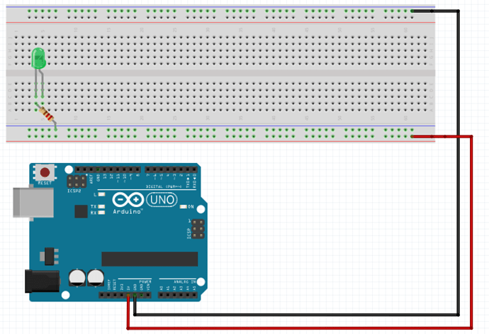

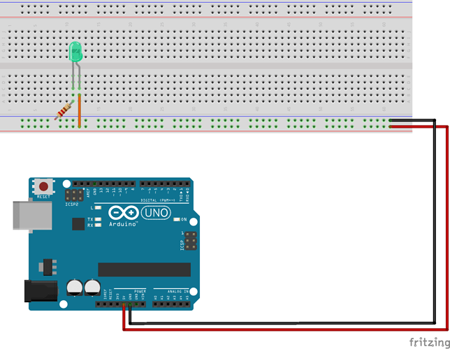

Hi! This is probably a stupid and silly question, but I was just wondering whether the positioning of the ground and positive wires had an impact on the circuit. For example, will the wires' positioning affect the LED lighting up in the attached images? If so, which image is correct and what would happen in each image?
I'm sorry if the words on the board are not clear enough, but the black wire is connected to the ground pin and the red wire is connected to the 5V pin (even though that's already pretty obvious).
Thank you!! :slight_smile:
None of those circuits will light the LED.
On the breadboard the 2 sets of red and 2 sets of black strips are not connected, so, for example, in Screen Shot 2019-05-10 at 6.28.14 pm.png you have the power connected to the top strips and the LED connected to the bottom. The top strips are not connected to the bottom strips so there is no ground connection to the LED.
Screen Shot 2019-05-10 at 6.29.15 pm.png is OK.
Does that help?
EDIT: Chris is correct because you have only connected ground to the LED, not to +5V.

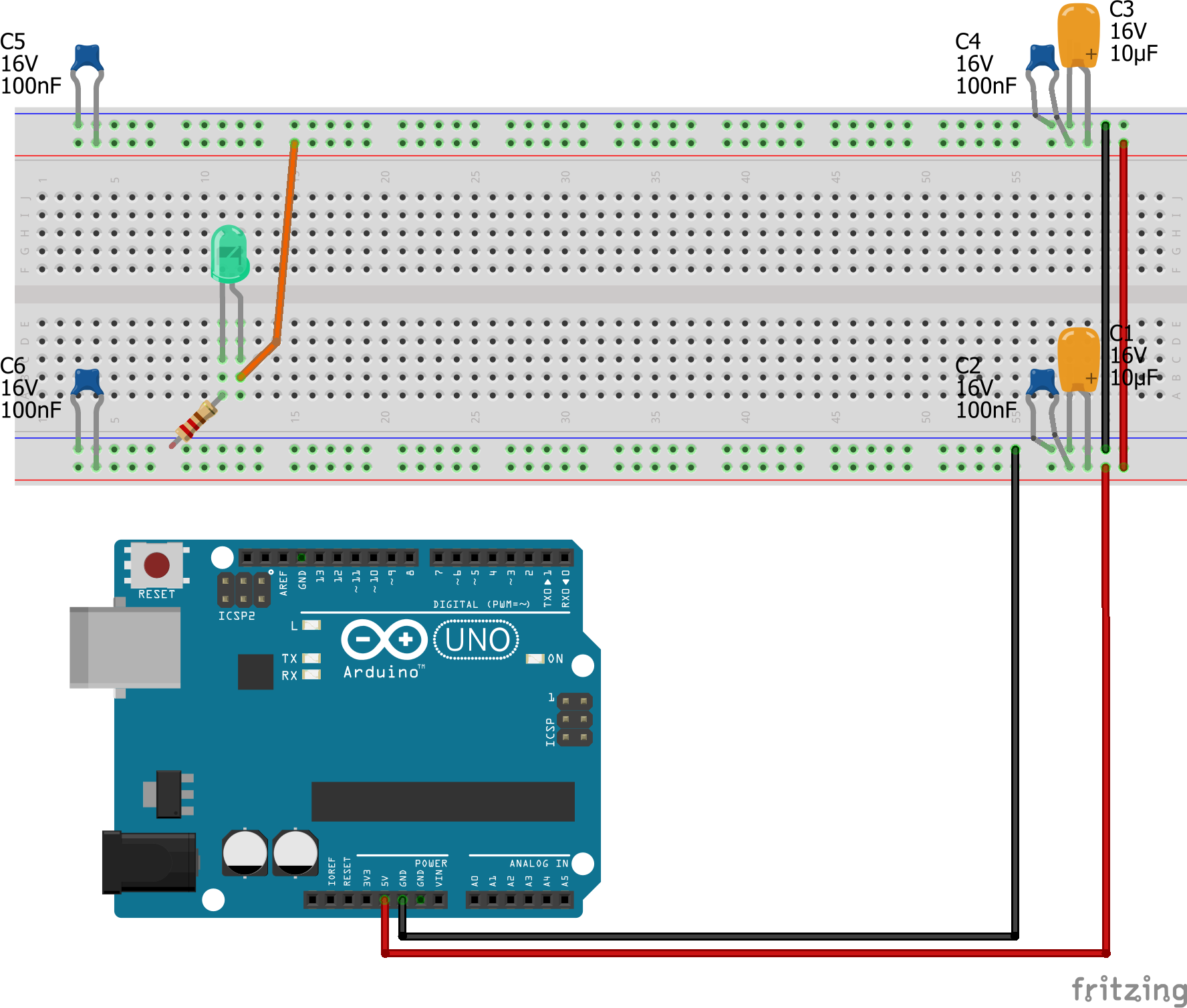

Here's the basic connection diagram needed to light up that LED:
Some breadboards have a bifurcated power buss that requires the following addition:
And this is how I set up my breadboard -- especially if any digital switching is involved [as usually is my case]. The caps help mitigate high contact resistance, which is typical for these breadboards, and the relatively long power lines. And, of course, add those extra jumpers if your breadboard is bifurcated:
BUT, for just lighting up an LED, the added caps is overkill. I just showed you that, for the future, when you get into blinking that LED, and beyond :wink:
BTW: Make absolutely sure you get the polarity right on those 10uF caps! Especially if they are Tantalum ["tants"], unless, of course, you like unannounced explosions [often fiery, in the case of a tant] :wink:
